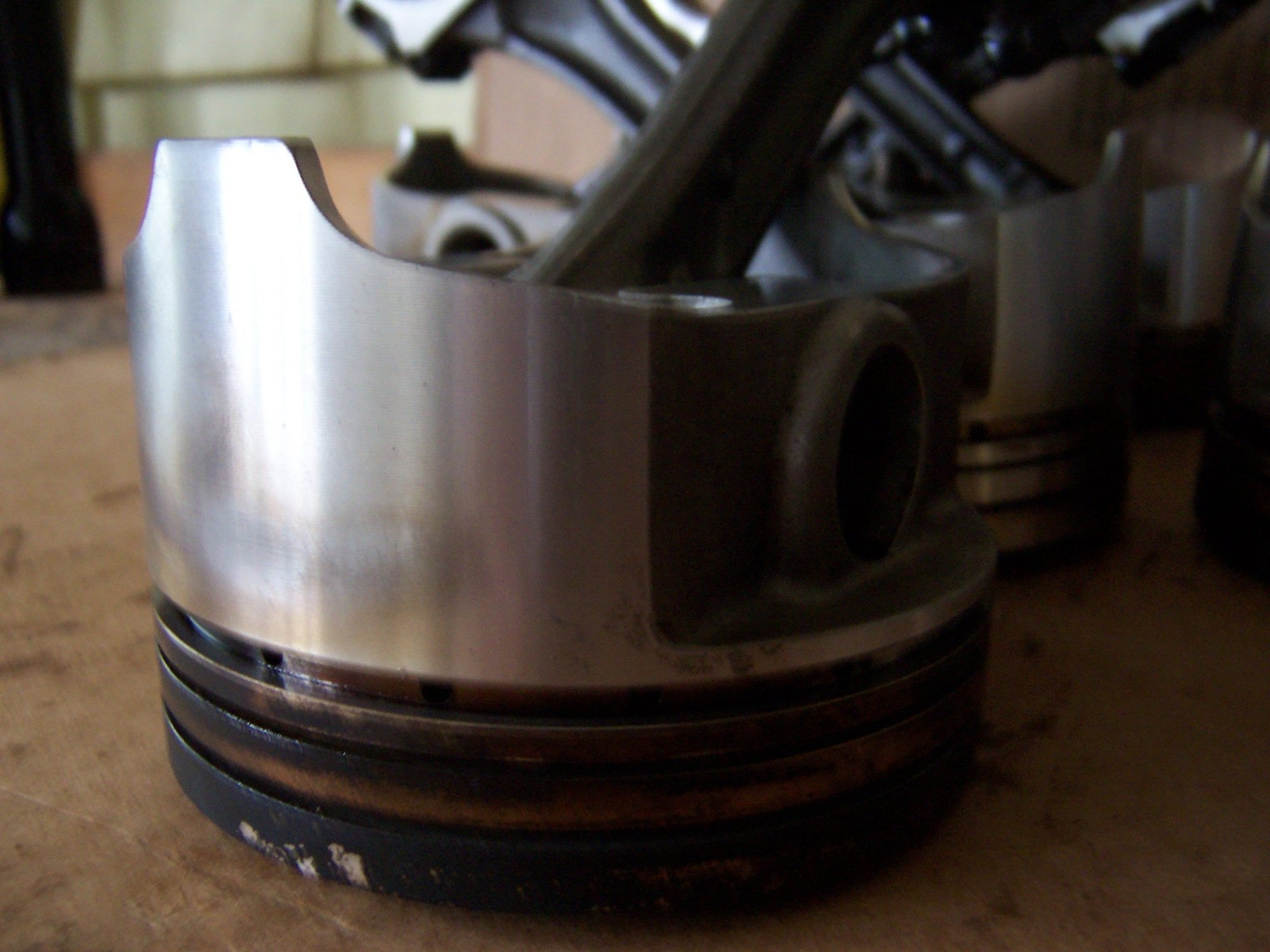

Agree Ive ran the 51060R for years on my boat engines we might not be racing but a constant load @ 70 for 25 miles I want good flow
That's all I ran for 15 years and when I tore the engine down it appeared I could've run it for another 15. Seeping head gaskets between cylinders was all I found.
