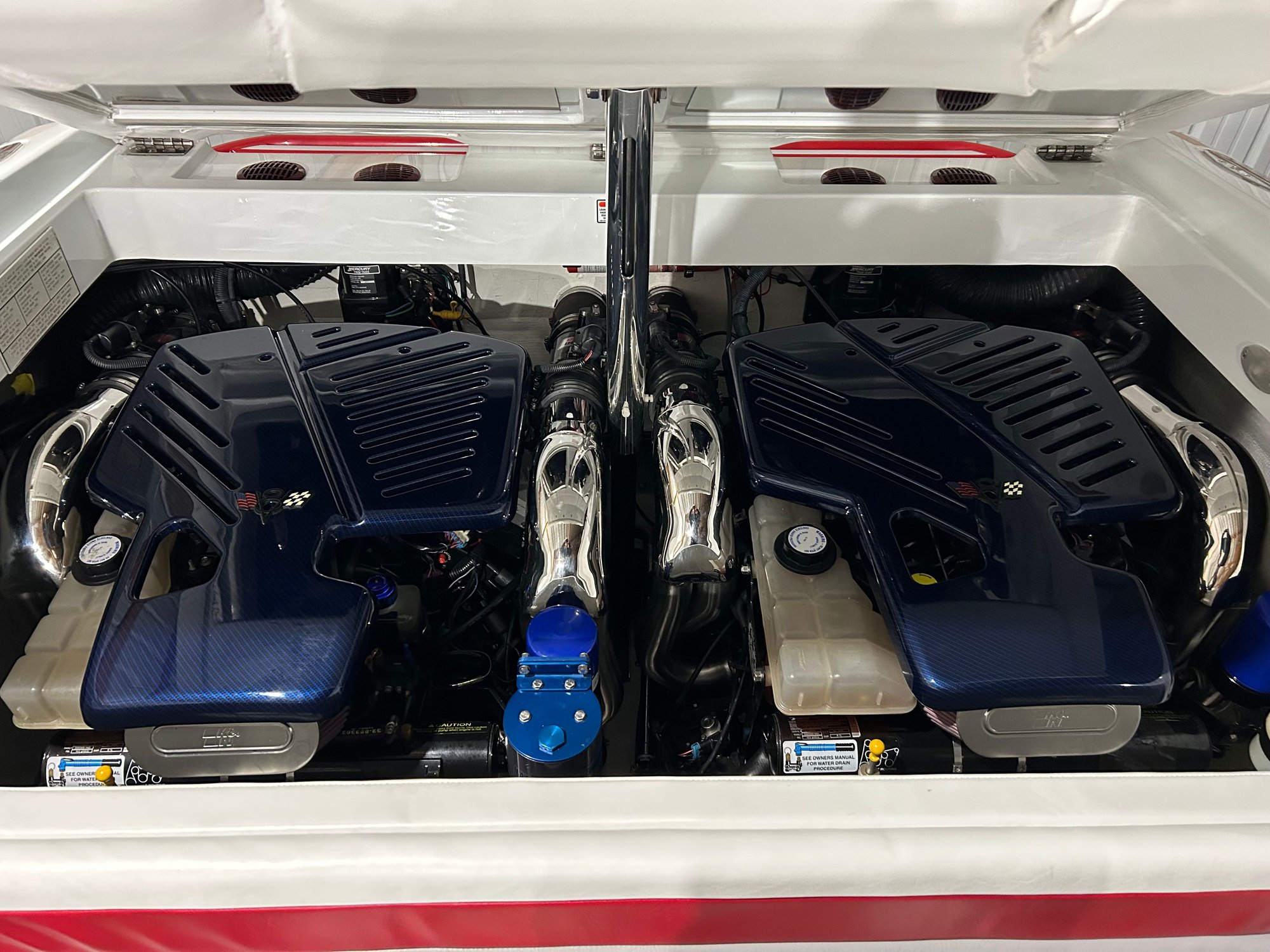

Brad,
my current situation, I personally I like the way they look stock but you do you, by the way you should have a fuel schrader valve on your fuel rail. I owned numerous 496s throughout the years they all had them.

Originally Posted by boatnt
Brad,
BoatNT,
That looks cool. I particularly like the Corvette flags badging. How did you paint them, being plastic and all?
Yes, the OEM fuel rail has a Schrader valve. I just figured that a FP gauge anywhere on the high pressure circuit would suffice. I can add one easily enough, and will do so before final assembly.
Thanks. Brad.
Brad Christy is offline

BoatNT,
Thanks. Brad.
Hydrodipped, and I thought the corvette badging adds a like to the look,lol
