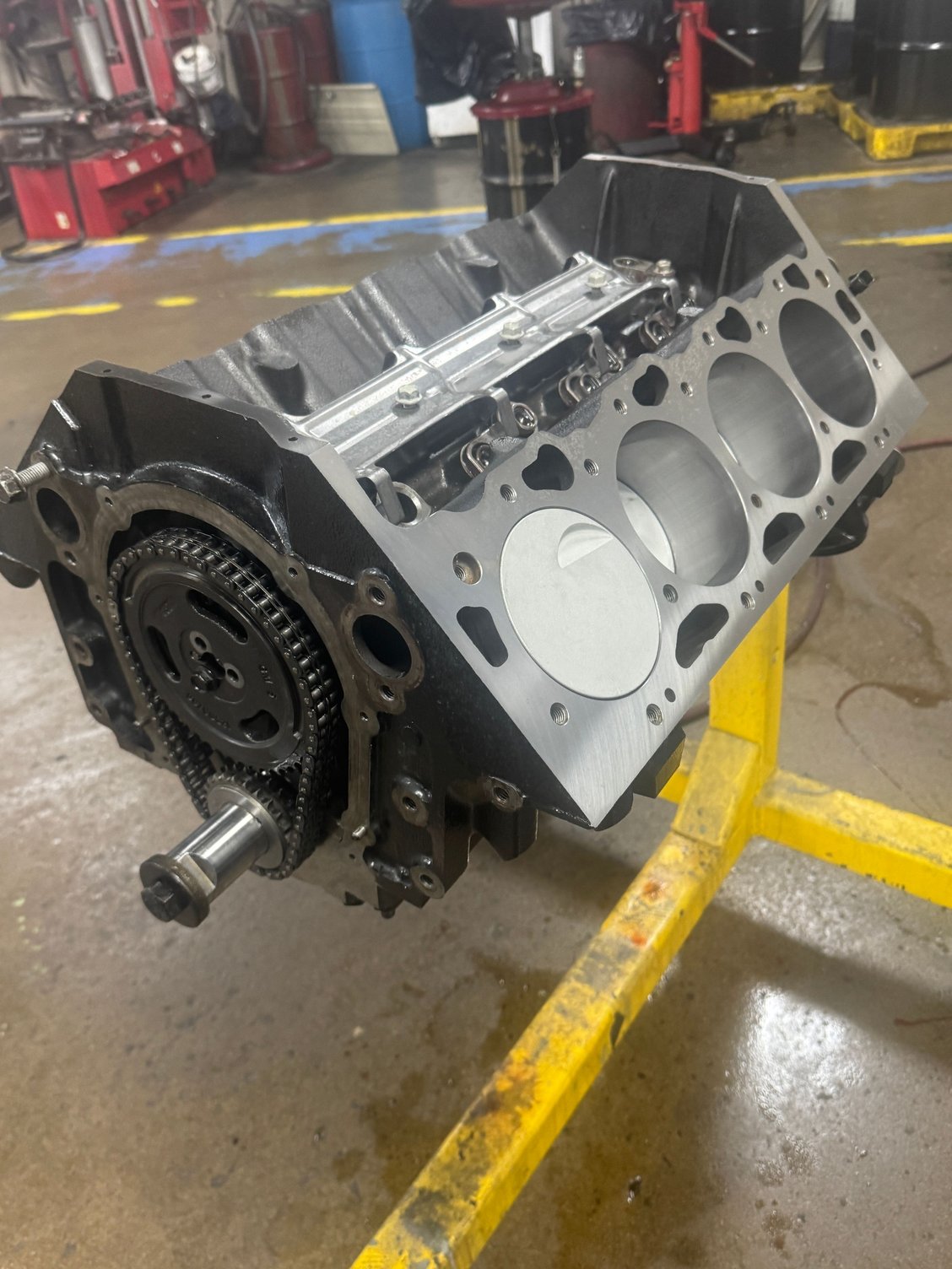

Guys,
Coming together. Head Gaskets should arrive tomorrow. Then we’ll start moving forward again.

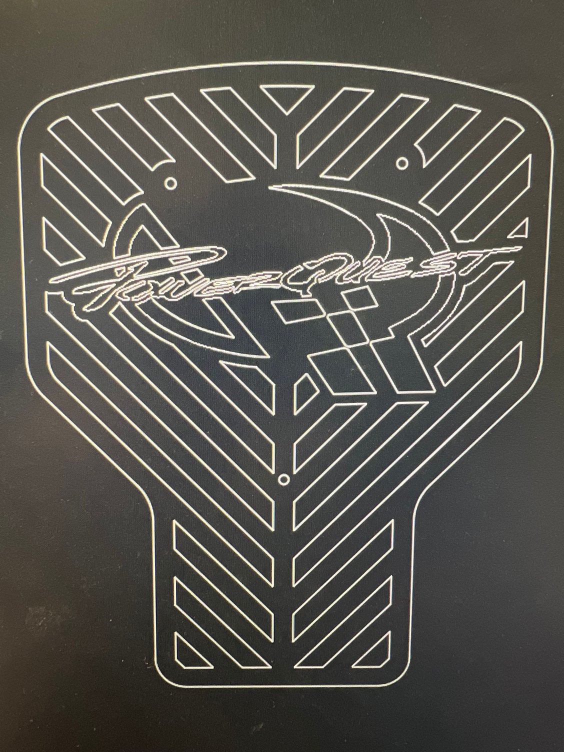

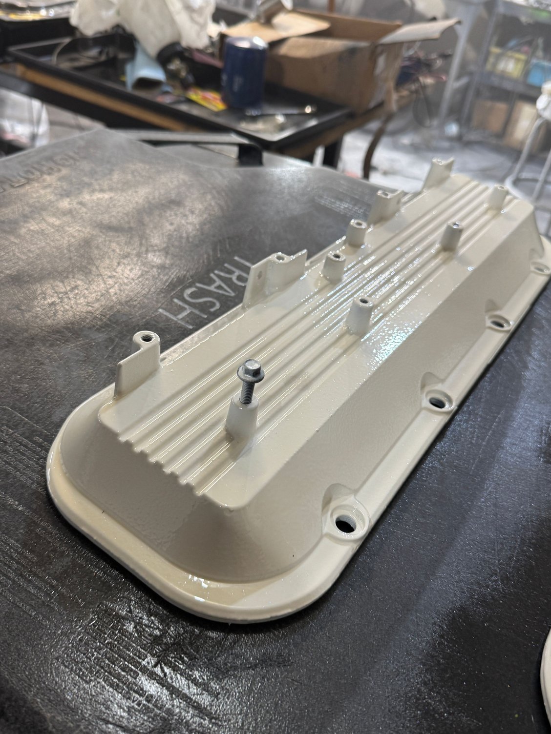

Thinking about aesthetics a bit….
Intake is gonna be the same pearl white. Leaving the block black. The coils should look pretty cool contrasting against the valve covers. Planning to have an engine cover laser cut out of aluminum that will be powder coated in the same Illusion Purple the rest of the trim on the boat is done in.
I know I need to make provisions for access to the oil fill tube. I’m having a friend laser cut them out of posterboard until I get it just right. Should look pretty badazz when it’s all together.
Thanks. Brad.

Short block already built , damn that was FAST!!!
