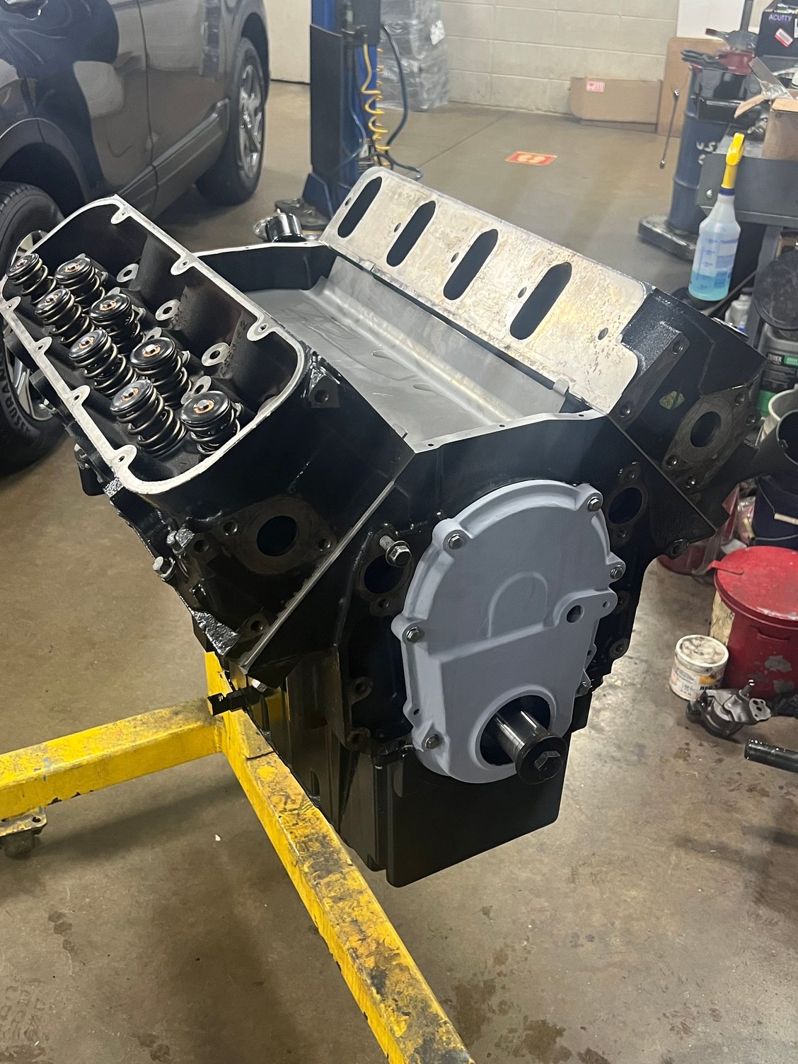

Short block already built , damn that was FAST!!!
Dan,
Yup. He’s in really tight with a racing machine shop, so they pushed it through. I was also able to get everything on demand. Literally everything I needed was on the shelf, ready to ship. Once we decided on a course of action, everything has been falling into place pretty smoothly. He’s got the head gaskets in hand now, and I’m hoping the rockers, as well, so the long block is on a pretty short horizon. Hell, if the weather holds out, we might have the boat in the water before Christmas. Seriously.

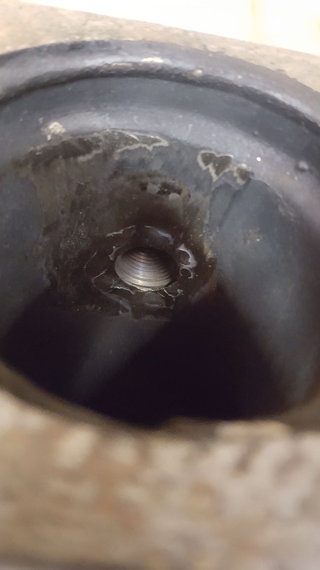

Guys,
Anybody have pics of their O2 sensor weld-in bungs? Look specifically for pics of the inside weld.
Thanks. Brad.

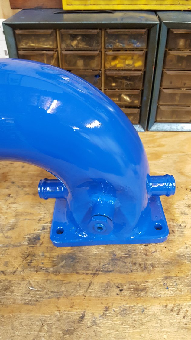

My 496 risers. I used Eddie Young's writeup.

Originally Posted by Padraig
Years ago, Eddie Young posted a good write up on welding in O2 bungs. If I remember correctly it also had pics. Try a search.
Padraig
Padraig,
How to install oxygen sensor bungs. - Offshoreonly.com
Found it!
Thanks. Brad.

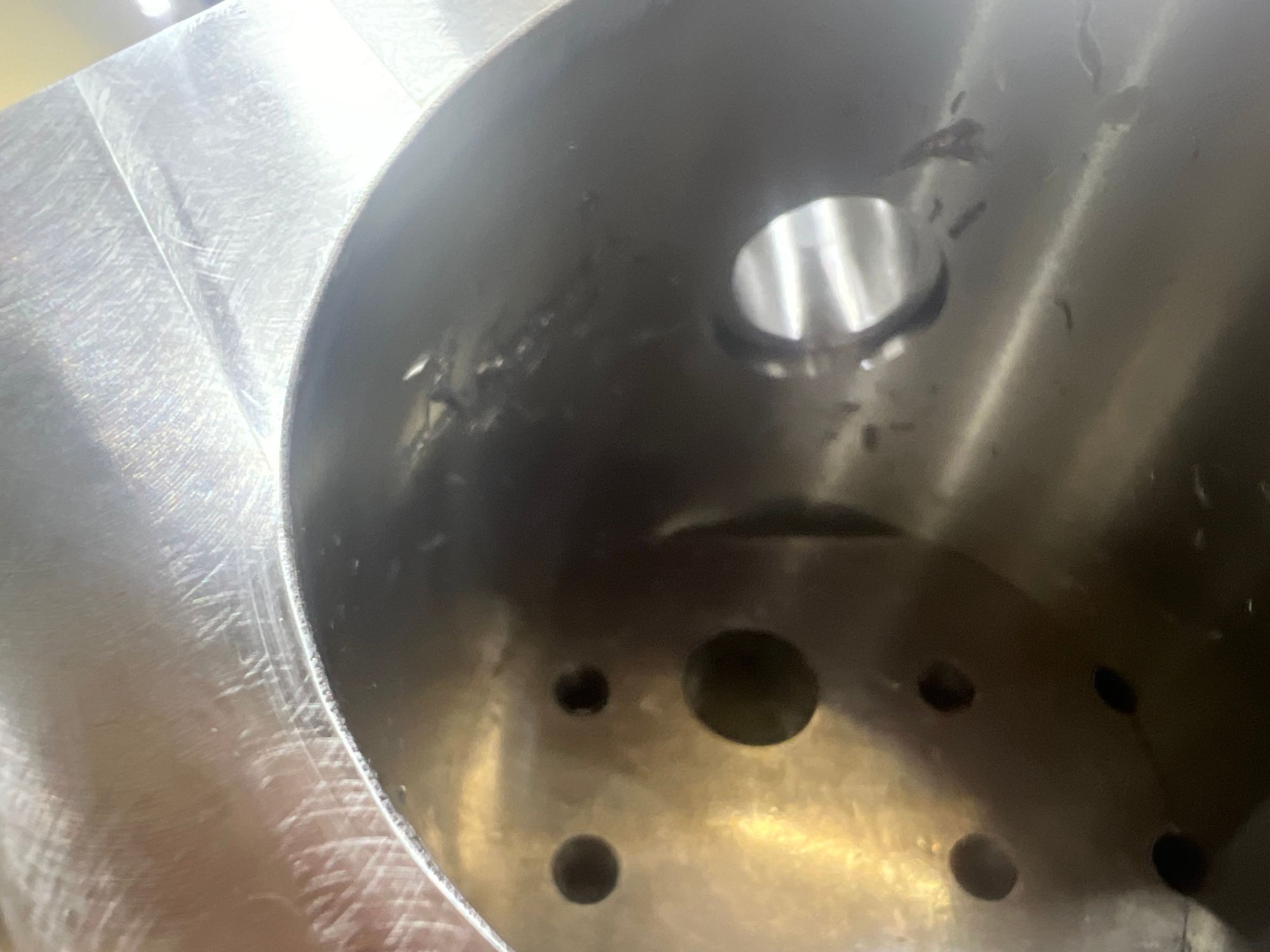

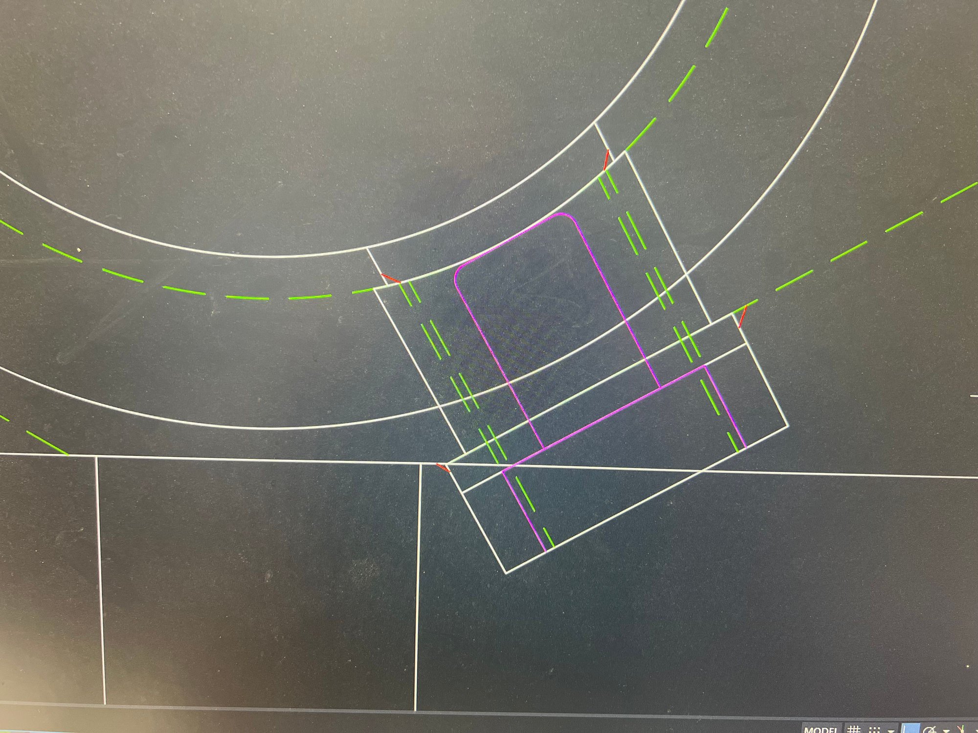

Guys,
Crap…! Time for a bit of a rethink on the plumbing of my tilted riser blocks, too.
I hate it when I get ahead of the build, then realize a plan was sideways all along.
Thanks. Brad.

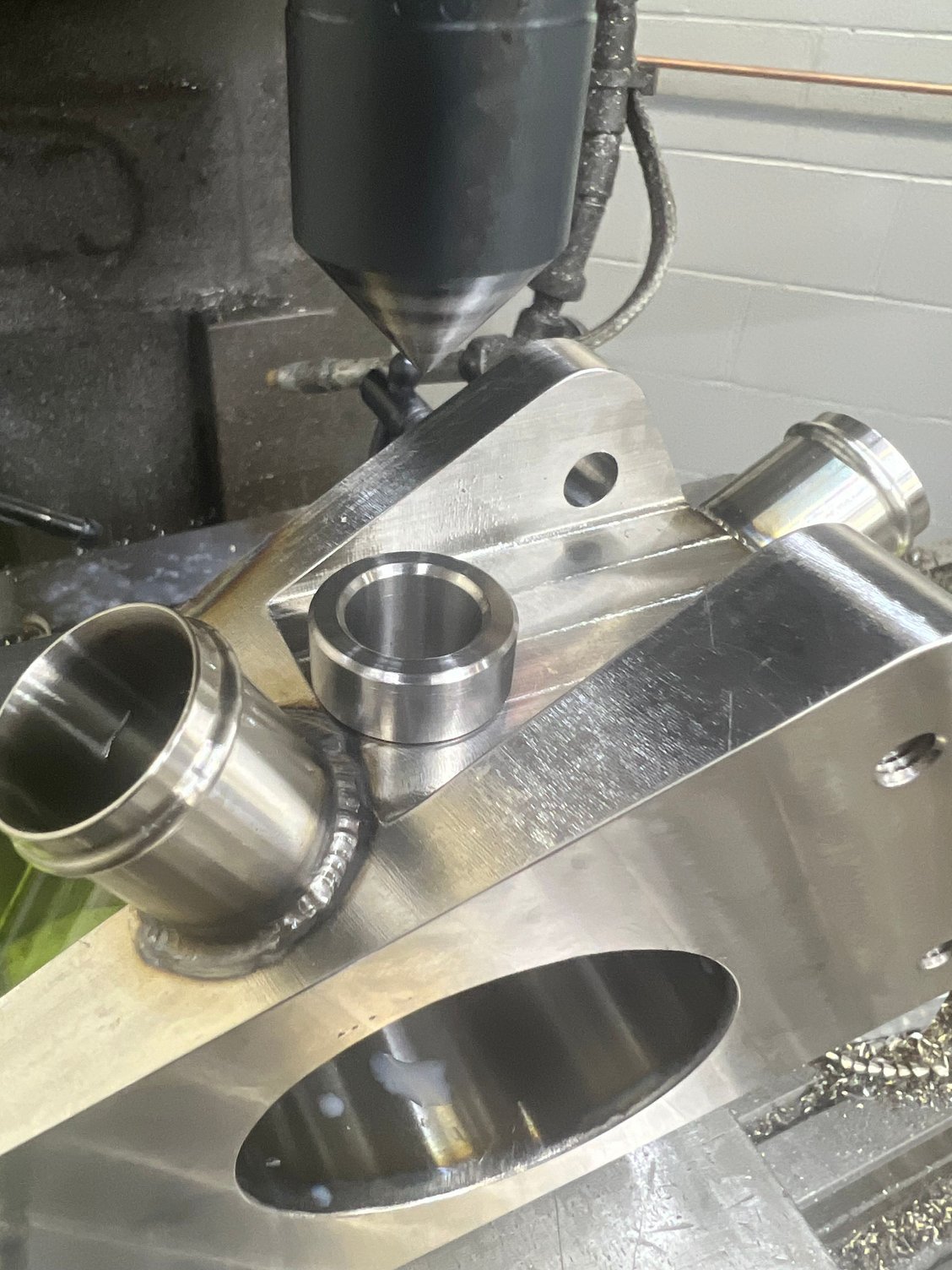

Guys,

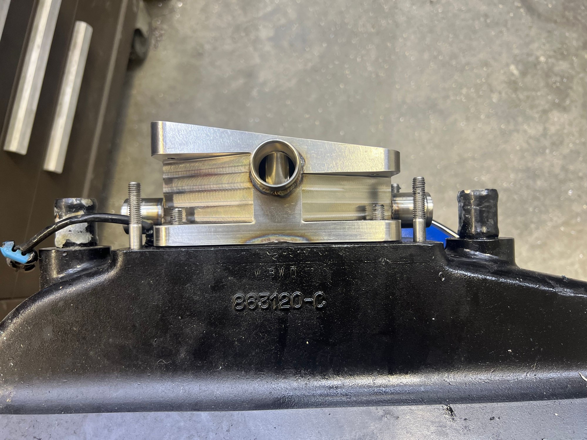

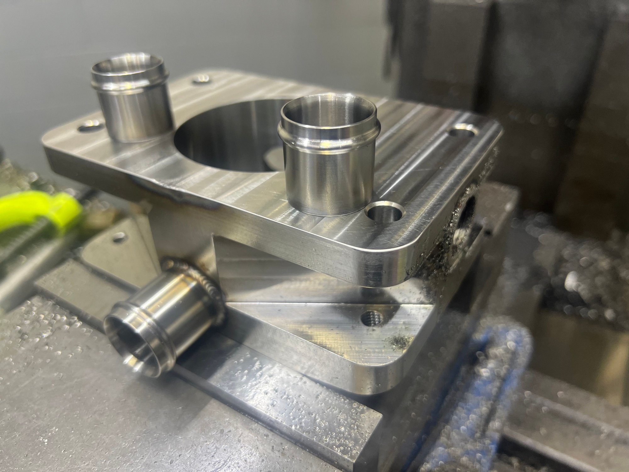

I have a plan for the riser blocks.
And for the O2 sensor bungs.
Thanks. Brad.

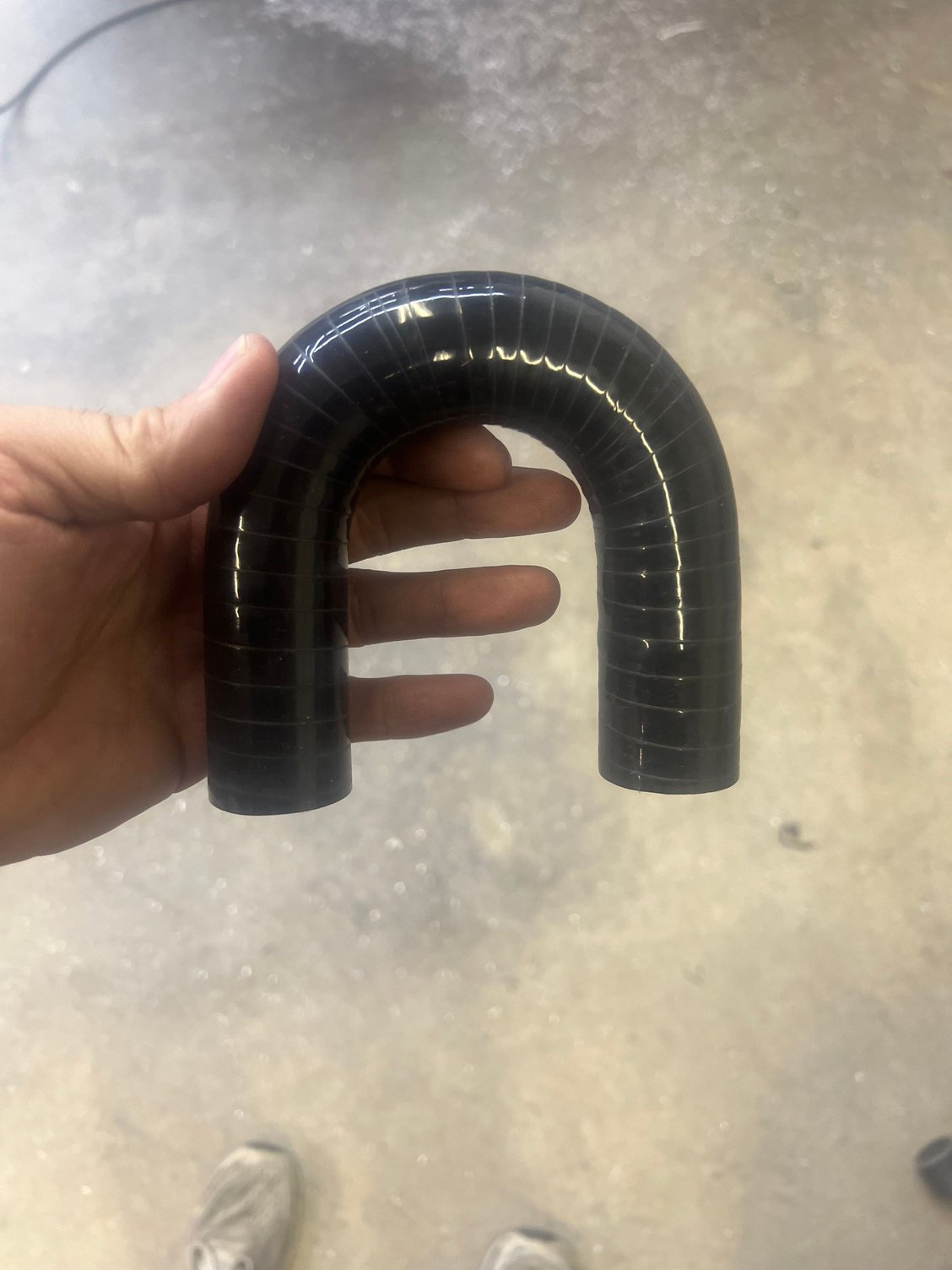

Originally Posted by sonicss42
Sure is purdy, but will it work? You sir have some talent.
SonicSS,
Thirty-some-odd years of making chips ought to account for something.
Shouldn’t be any real issues with it not working. It’s just a water jacketed exhaust riser. Pretty basic function. The only thing I’m worried about now is the interior water outlet conflicting with the valve cover. Won’t know how that is going to work out until we get to that point.
Thanks. Brad.

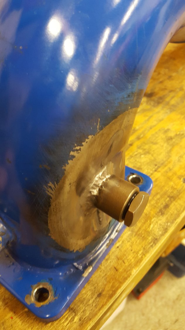

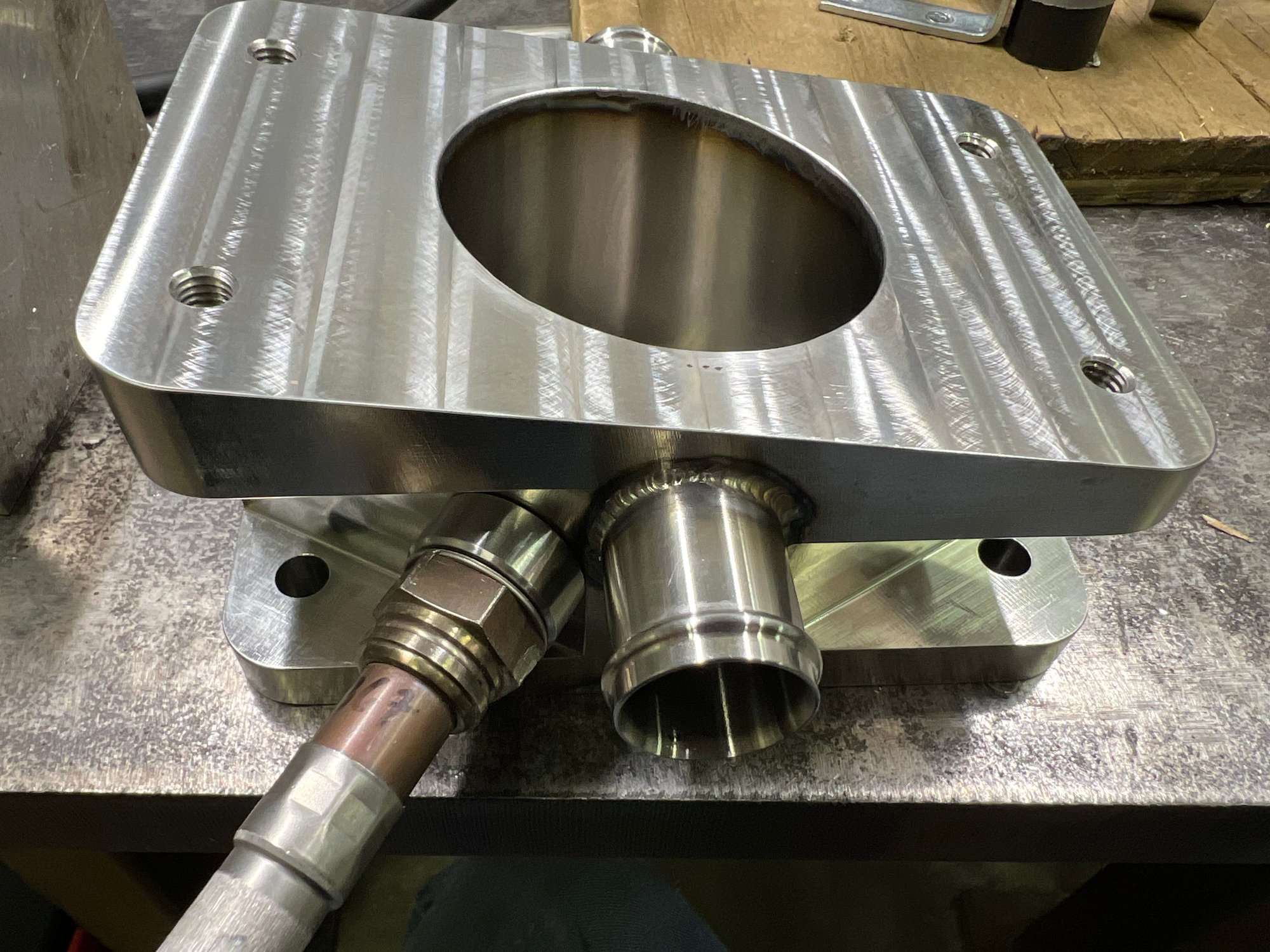

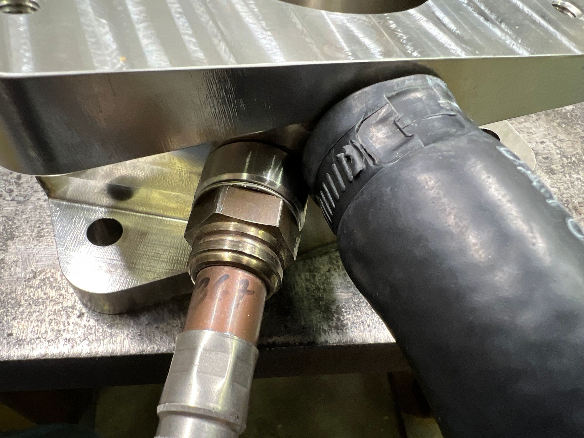

Guys,
A little bit of progress. Scorpion Endurance Marine rockers are on order and should be in hand soon.
O2 sensor fits snug, but it fits. Both sides have a bung. They will be welded in tomorrow, as will the elbows that correct the plumbing conflicts.
We will use closed loop to set the tune, then convert to open loop. The builder already has a base tune built that he expects to be fairly close. I believe there’s a O2 reader that transmits Bluetooth and has a mobile app….? I may go that route, just to check in on it occasionally, but I do not intend to run the boat in closed loop.
Thanks. Brad.
