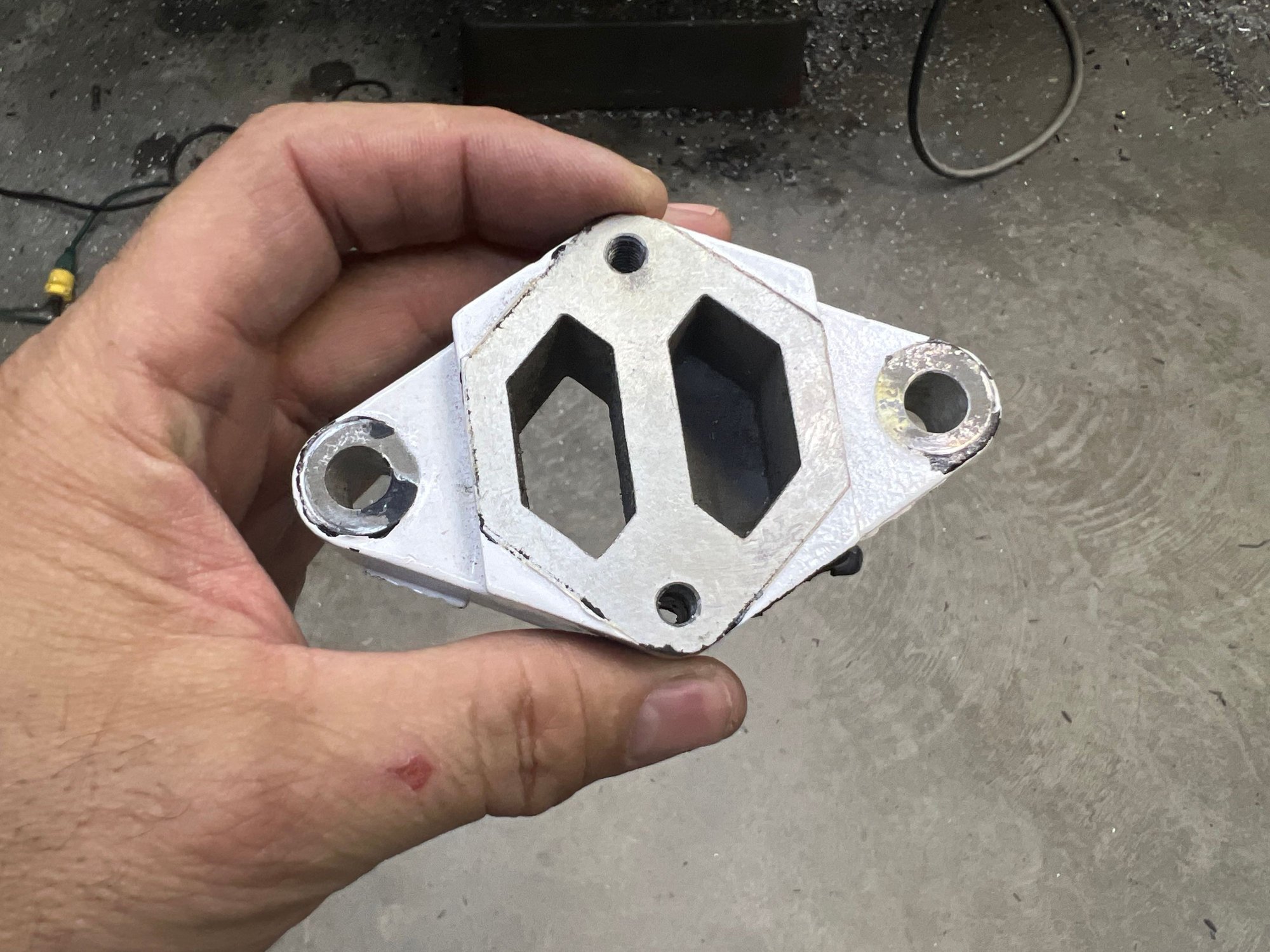

I don’t want to get into a bashing session on the builder, as I’m confident in the engine he built, mechanically, but he was struggling to get anywhere and admitted to not having a strong grasp of the Holley stuff. I have a new guy doing the tuning on the engine. A mutual friend turned me onto the guy that does his drag engines, and this guy REALLY knows the Holley stuff. After making a few changes to the basic tune parameters, like enabling “idle spark”, we have it starting at zero throttle and purring like a kitten…
On his suggestions, we also made some hardware changes…
The old Ford IAC adapter plate
Machining a block-off plate
Old IAC location deleted
New GM stepper IAC installed on the throttle body
No more hose from the IAC at the rear to the throttle body.
We also adjusted the throttle stop a bit. There is a ~5-16” hole in the throttle blade; OEM Merc. IAC now runs ~5-10%.
The TPS also seemed to be getting flaky and losing signal, so he gave me a new one. The new wiring is laced into the harness and everything is all buttoned up. Prop is on the drive and the drain plug is in. Looking at either tomorrow or Tuesday to head to the ramp for (hopefully) final tuning. I’m going to download the software on my wife’s laptop and he is going to to show me how to further adjust the tune through the learn table transfer. I’m hoping to not have to do that, but we all know how this goes.
