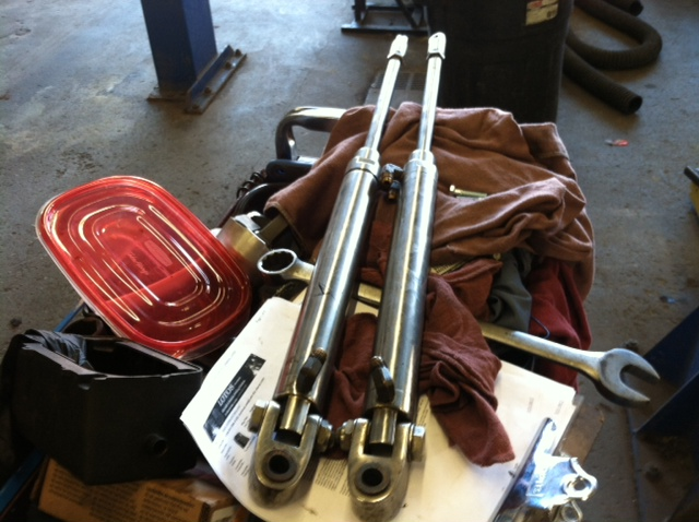

Old 03-23-2012 | 02:01 PM
Joined: Aug 2010
Posts: 2,535
From: MA
Default xr
Not positive on yr. Older one though
Attached Thumbnails Fukn a what do I do for steering-steering.jpeg   Fukn a what do I do for steering-steering2.jpg
scarab63 is offline

Old 03-23-2012 | 02:22 PM
Joined: Sep 2008
Posts: 945
Likes: 15
it is the older style. wonder if outside housing of early XRs have the same dimensions as regular old Bravo 2004 and earlier. If it would fit I have custom made top plate SS but not polished. I have plate, spacers, but you would need 6 longer SS studs/wash/nylock nuts. Also would need bolt or stud to mount rams to plate, but could probably use your old ones w/spacers, etc. I can get you a pic later if interested.
no limits is offline
