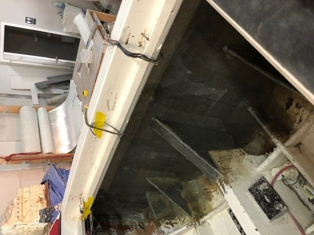

Following the post - what tools did you find worked the best for removing the inner transom rot??

First I took my little Ryobi electric saw. Cut cross patterns in the glass and through most of the wood making sure it could not hit the hull glass.
Used a prybar and hammer after that and that got most of it. Used a grinder to cut the edges of the glass. Hard to get to areas I used a vibracutter. On the stringers I used a sawzaw. About 80 percent of it went very fast. The edges along the bottom took a while and a ton of effort. But got through it after many itchy days.
Dropped her off yesterday at the glass shop. Will go over Monday to get the quote and plan to get her going again.

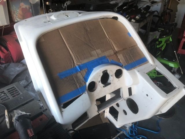

Cut out the gauge cutouts. Started mocking up card board templates on how I’m going to do the panel.

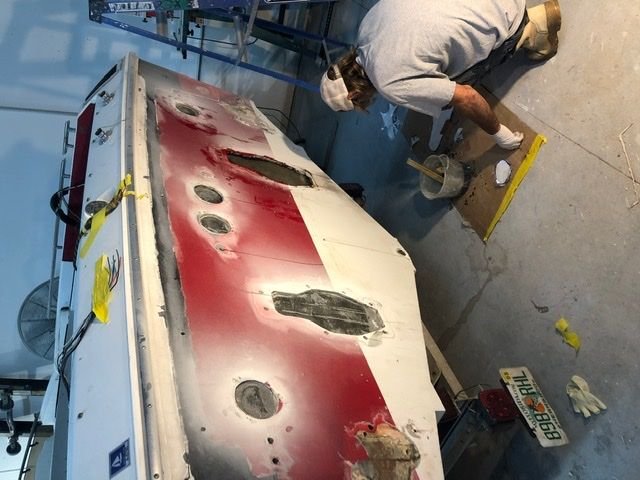

New Penske board transom installed along with the braces needed for the outboards.
they will fill and gel coat next. Should be picking her up next week.

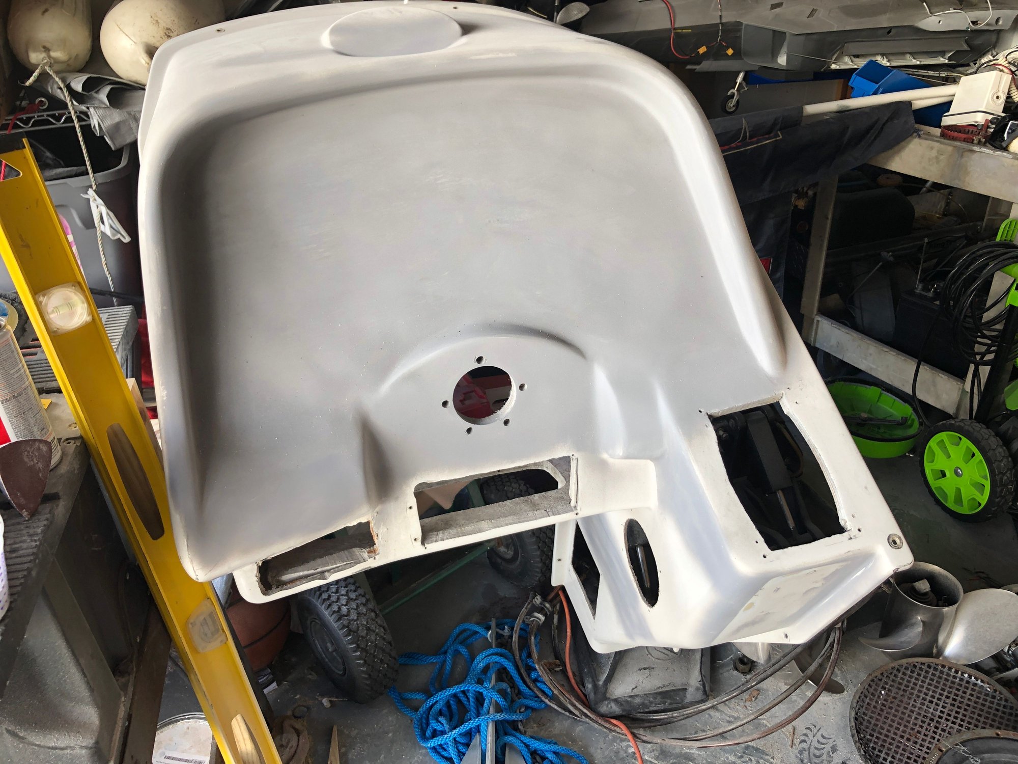

Started filling the holes on the console and glassed the top of the new flat panel. Will glass it into the console tomorrow.

Transom is done
now will be working on the wiring until the new engine bracket is ready. Should be picking it up January 11th. Should have engines on by the end of January

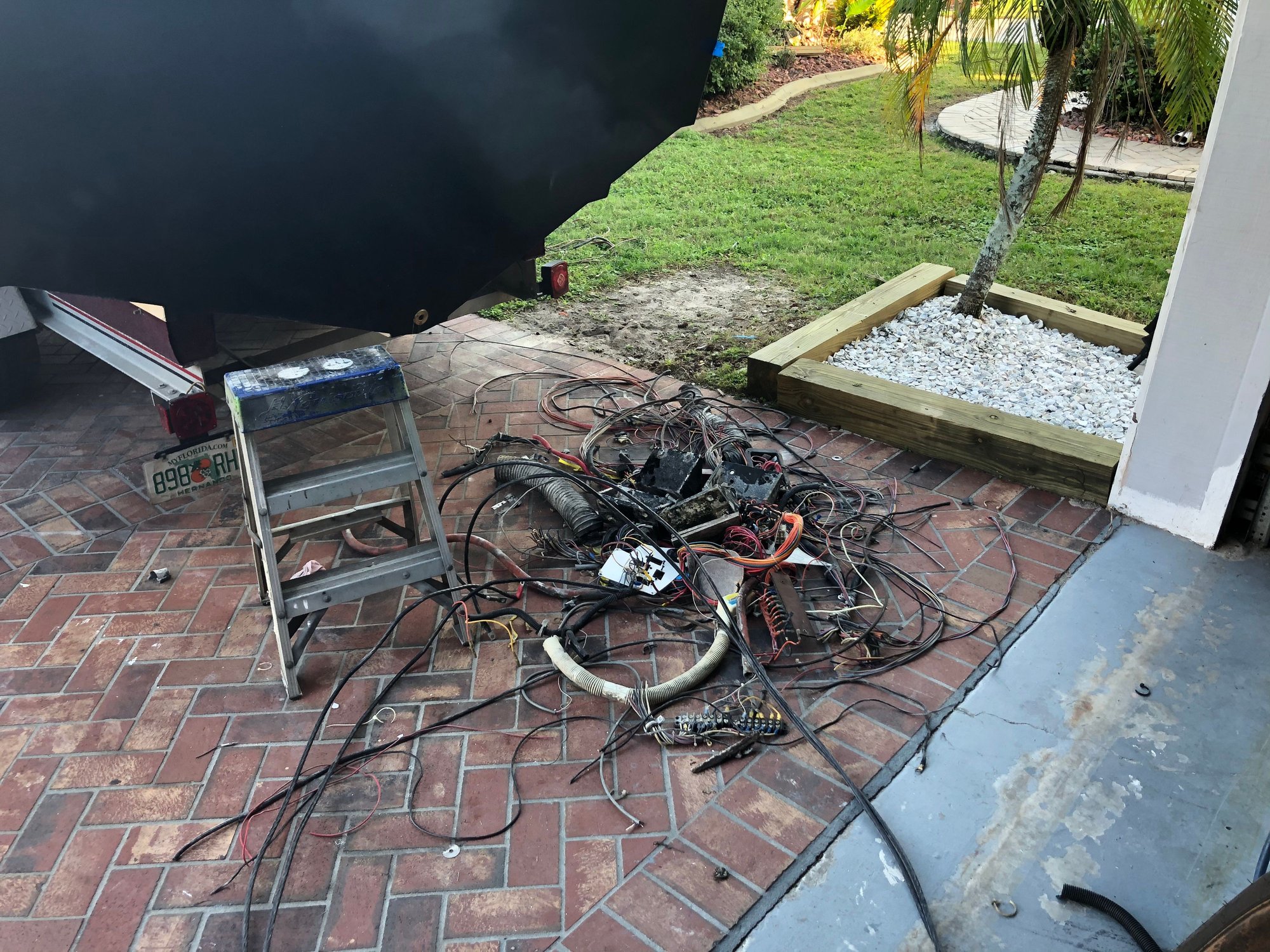

Things are moving slow but moving along. Decided to rip out all the existing wire and terminal blocks. Going to rewire the entire boat accept for the cabin.
