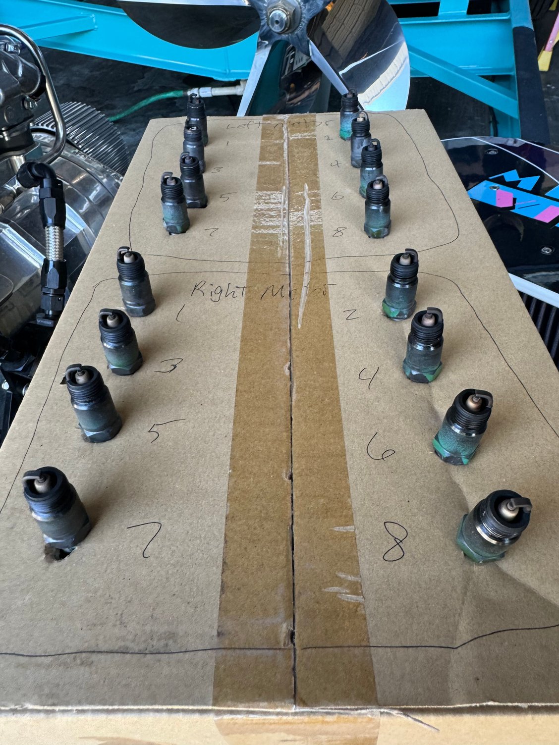

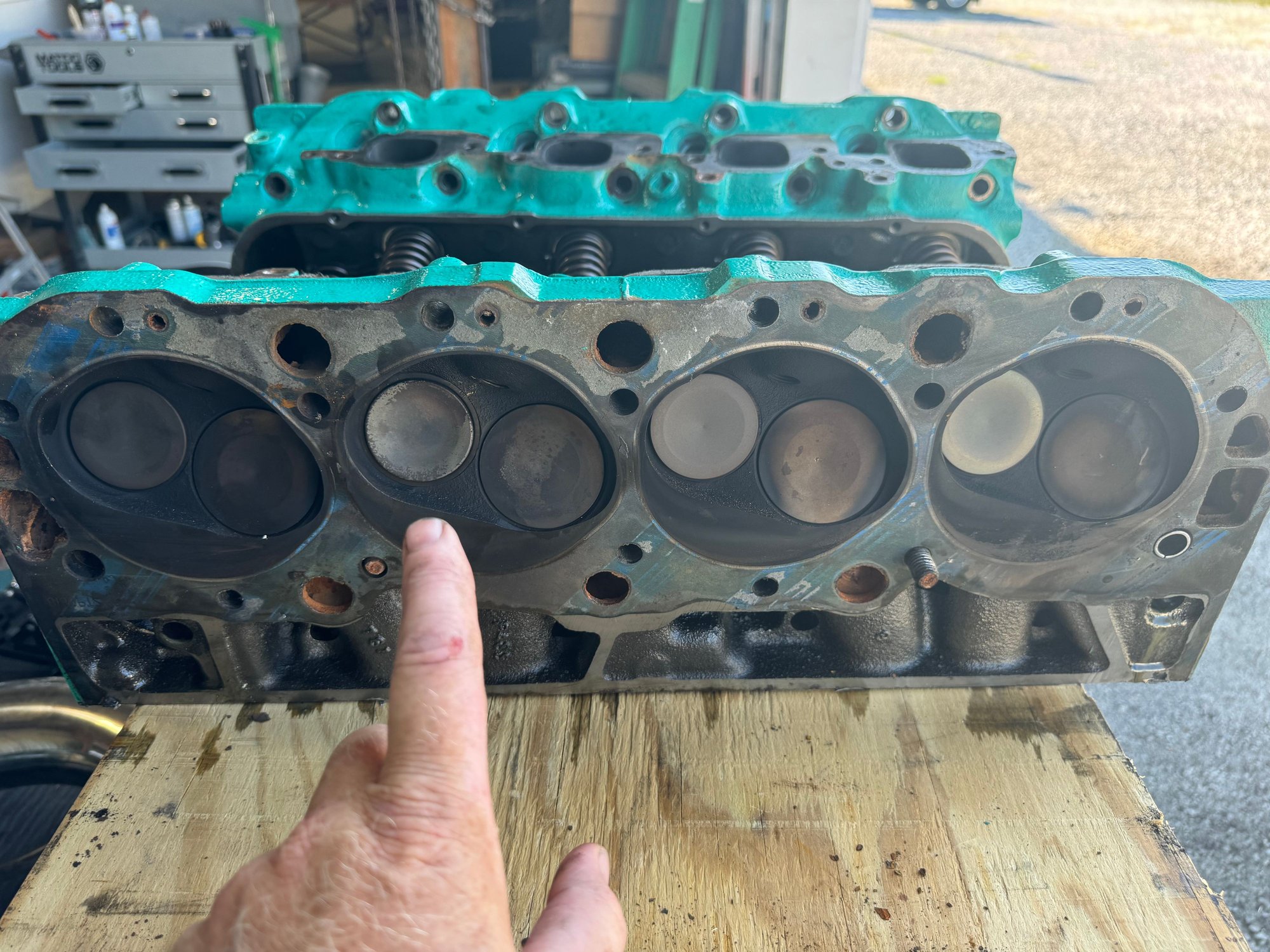

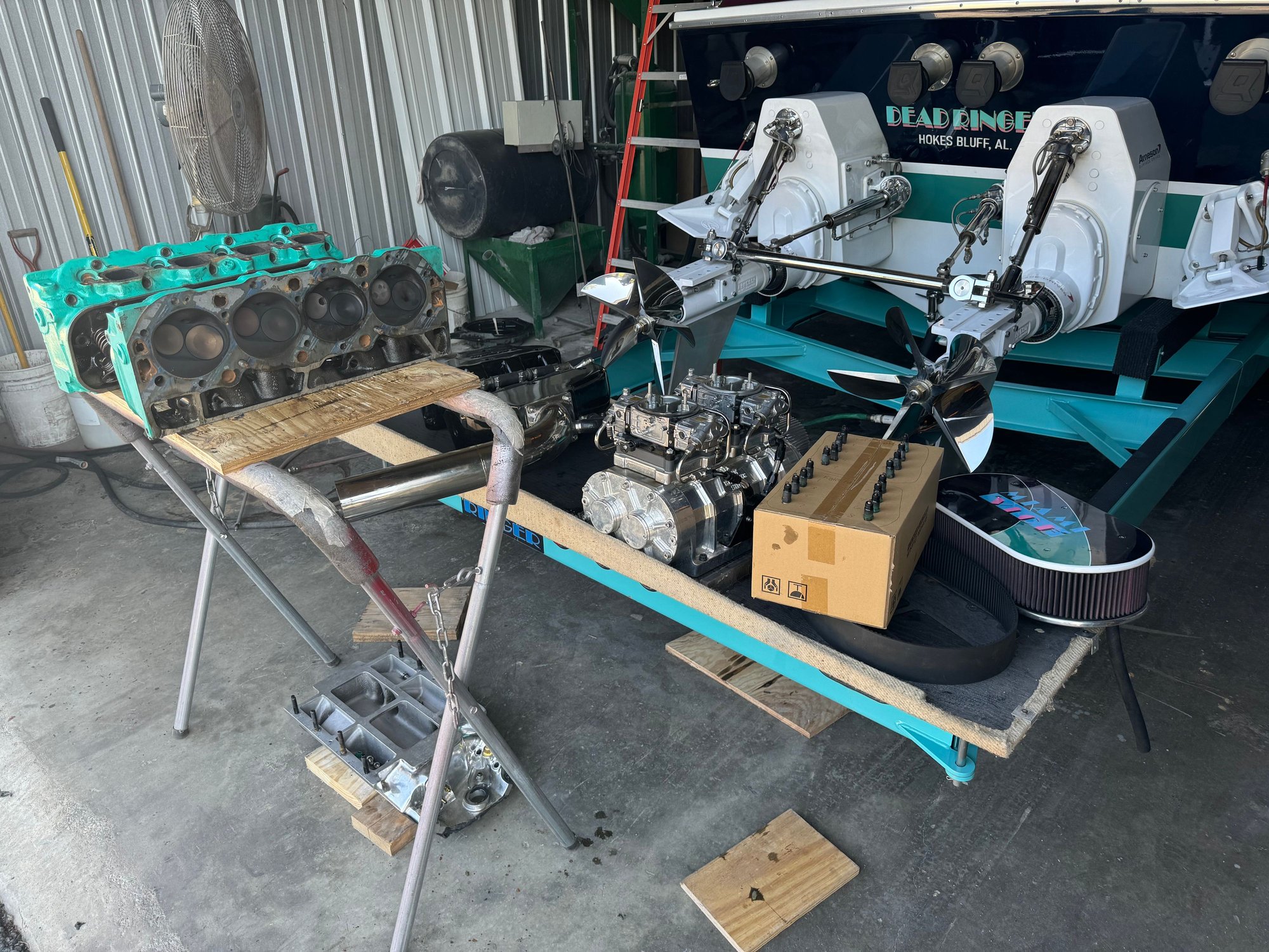

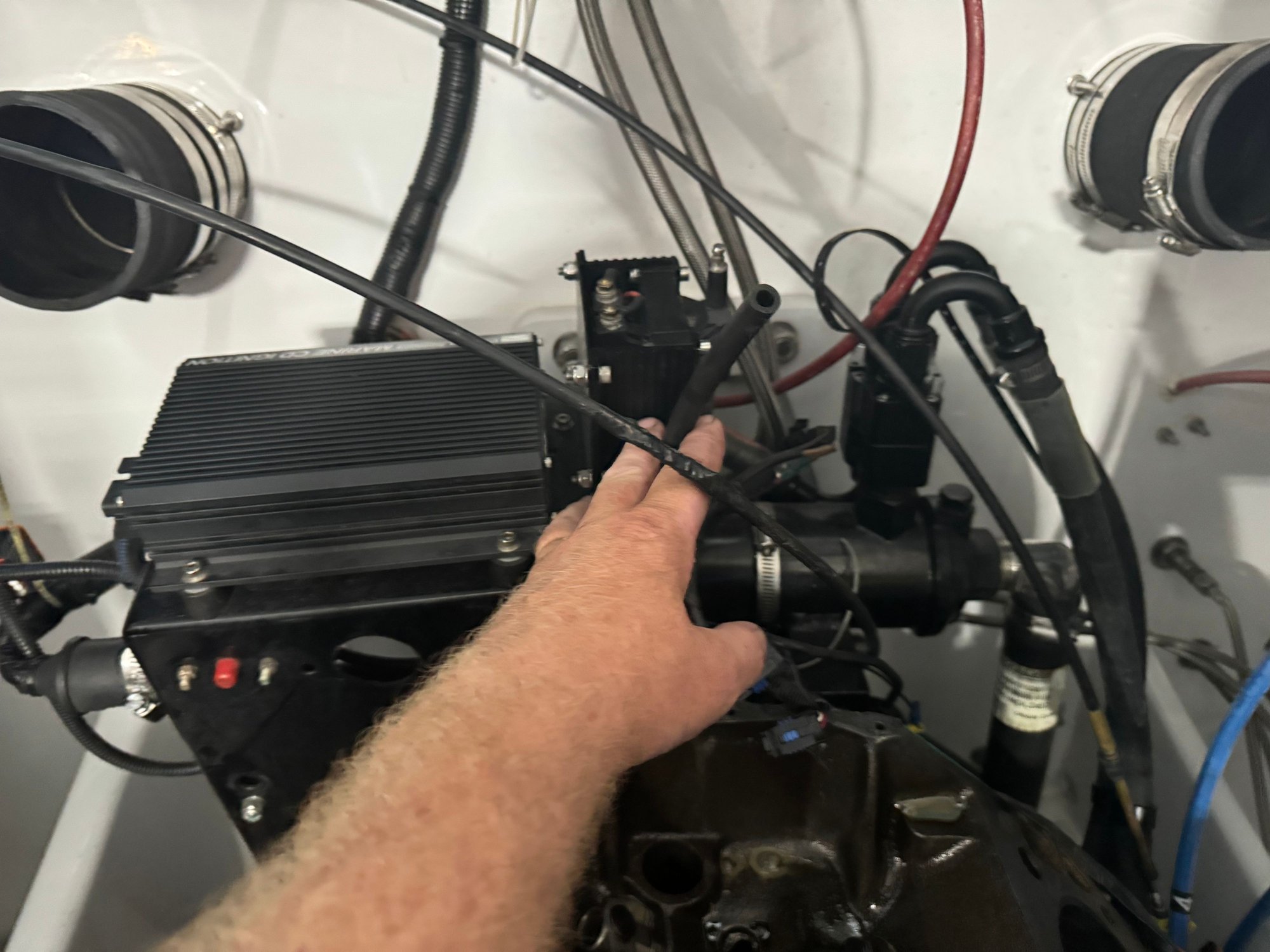

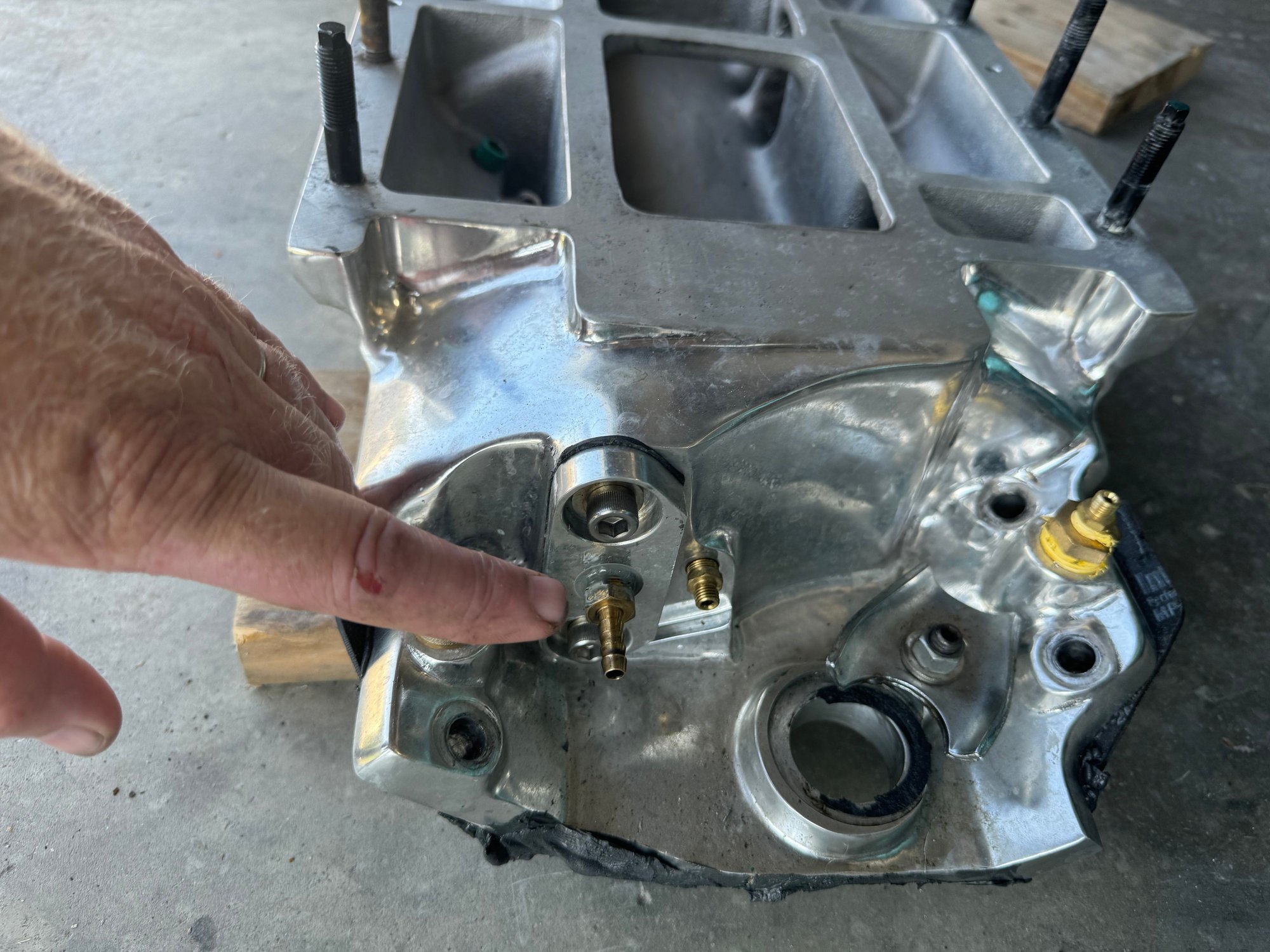

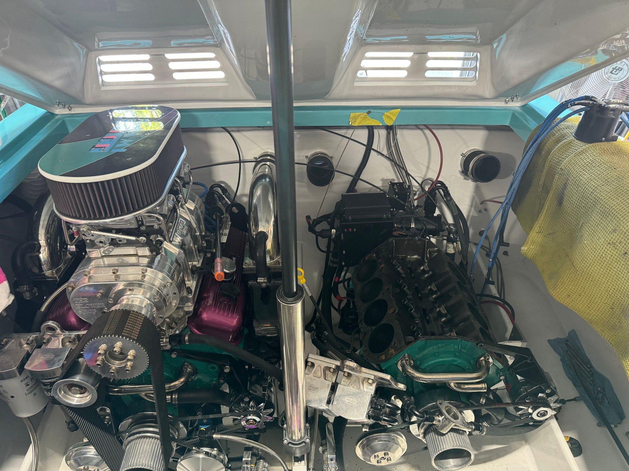

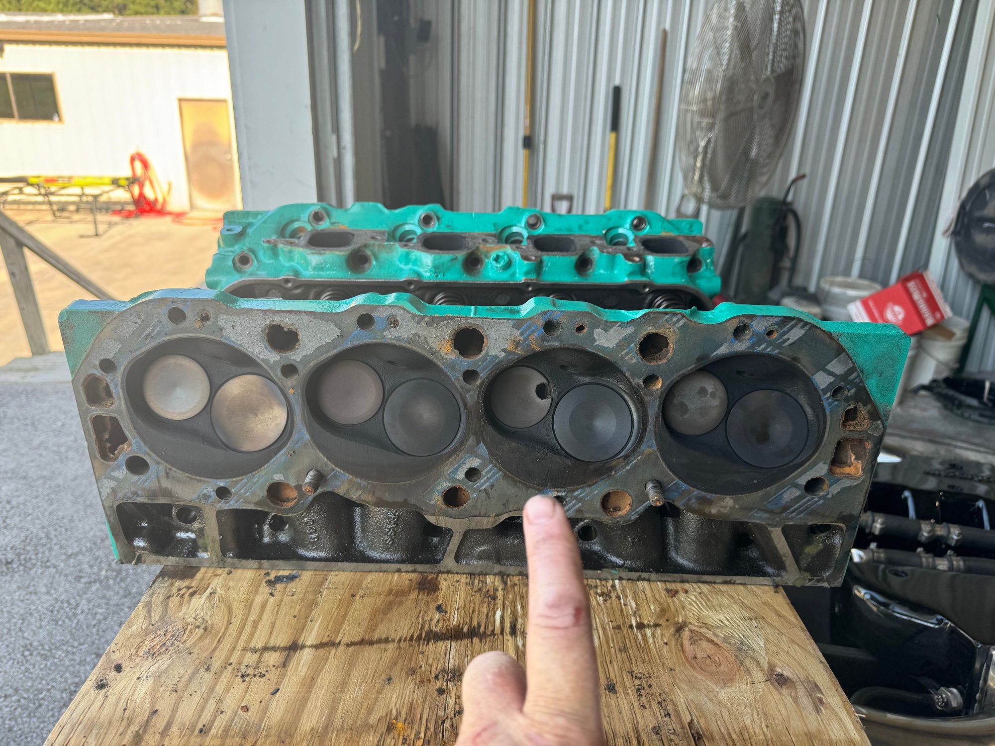

Left engine acted up the last time we had it out on the 4th of July. Hard to start, low on power. Sounded like it had a dead cylinder. Finally got around to a compression check. Left motor # 3 cylinder had 80 psi. #4 had 0! Put the scope in there, #4 had a hole in the exhaust valve, #3 had tuliped.
As I was taking it apart I noticed the MAP sensor hose had come off the manifold. Causing the ignition to be too advanced. Hindsight being 20/20, shoulda put a hose clamp on it. It was a tight fit on a barbed fitting I never thought would have backed off. Oh well, sending heads off Monday to be reworked. We’ll be back on the water soon.

Dang...
What exhaust valves are you using?
