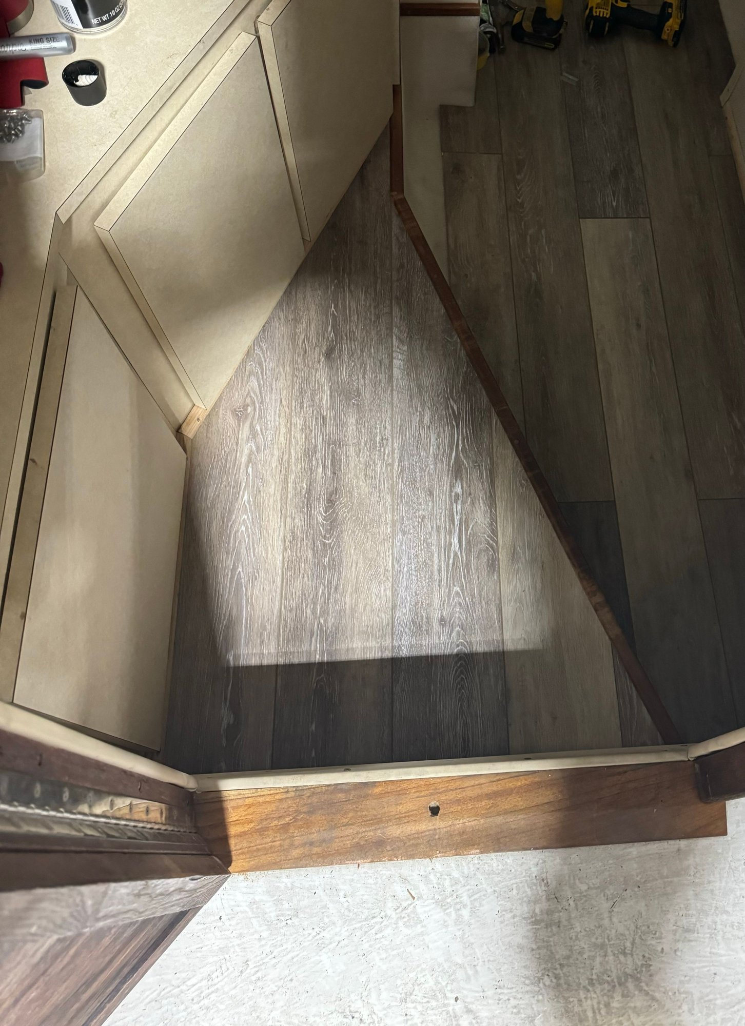

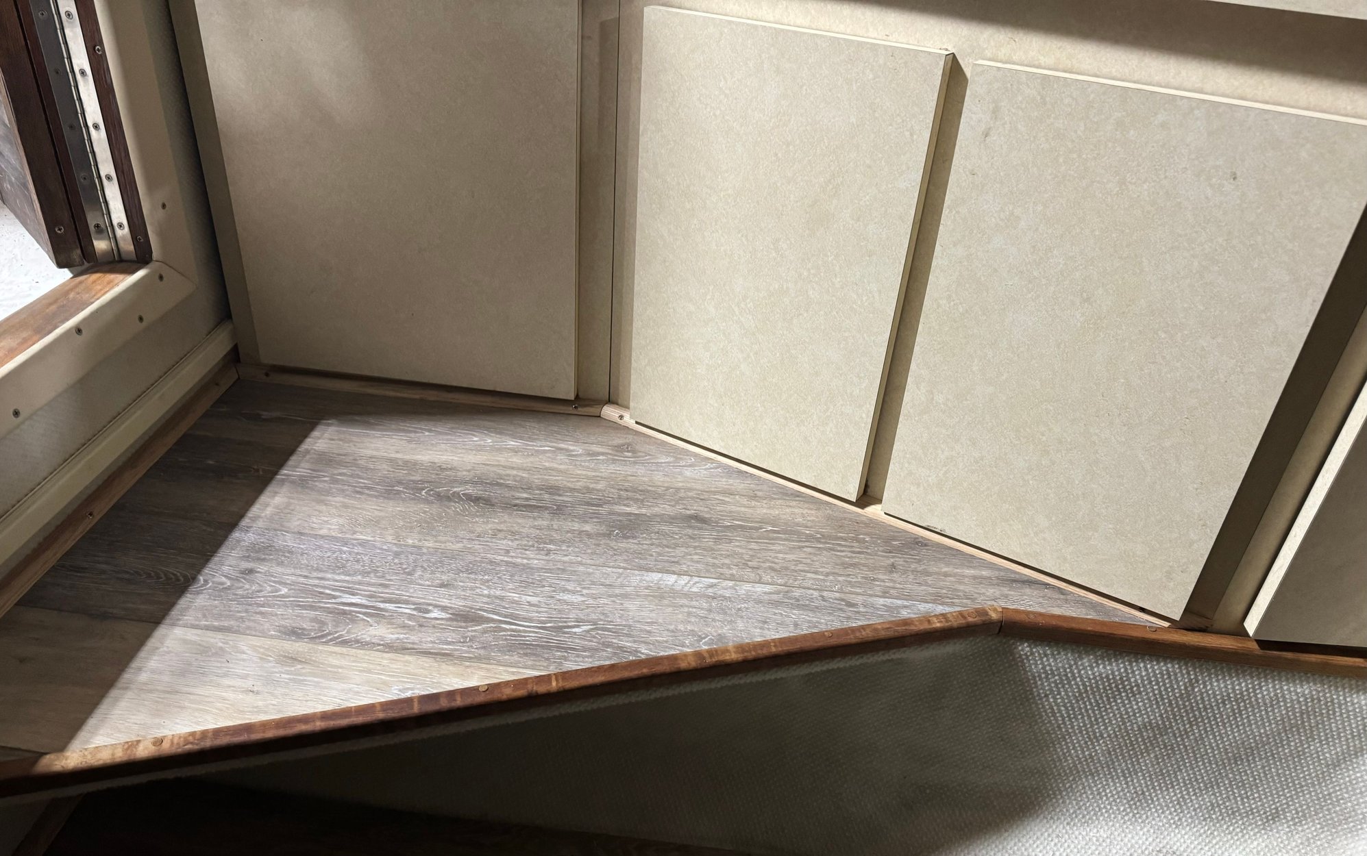

Hoping to be putting the port engine back together this weekend.
Ive been working on the cabin some. I put some teak edging around the flooring. Call me crazy but I don’t like carpet under my feet in a boat. Plus when the grandkids spill their chips, easy clean up.

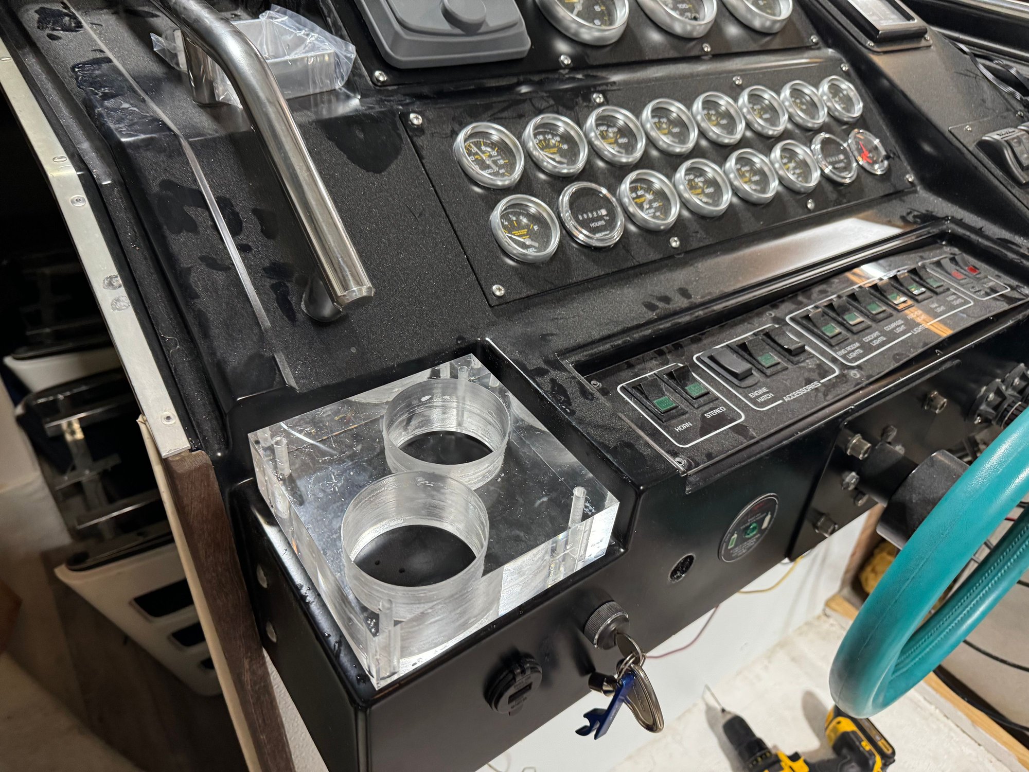

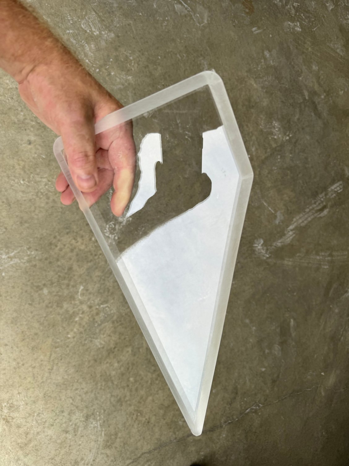

Also been working on some of the acrylic. Getting the cup holders fine tuned etc.

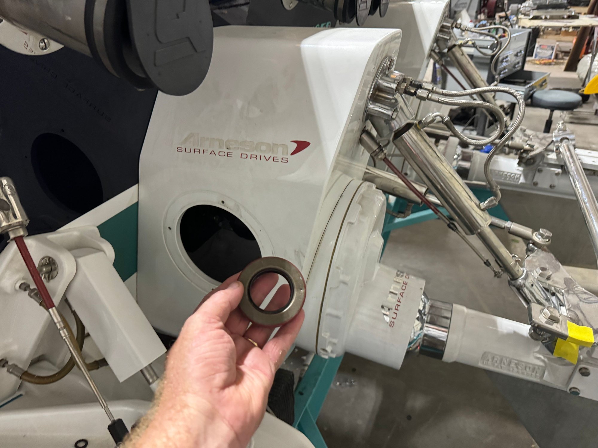

Also replaced the upper input seal on the left side a few weeks ago.
