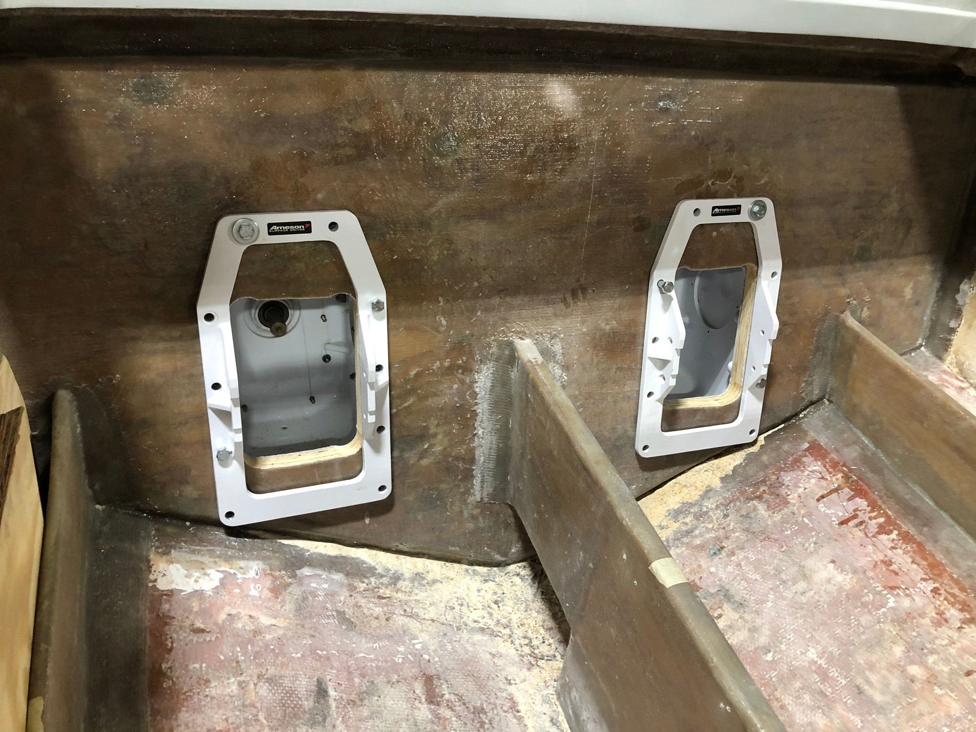

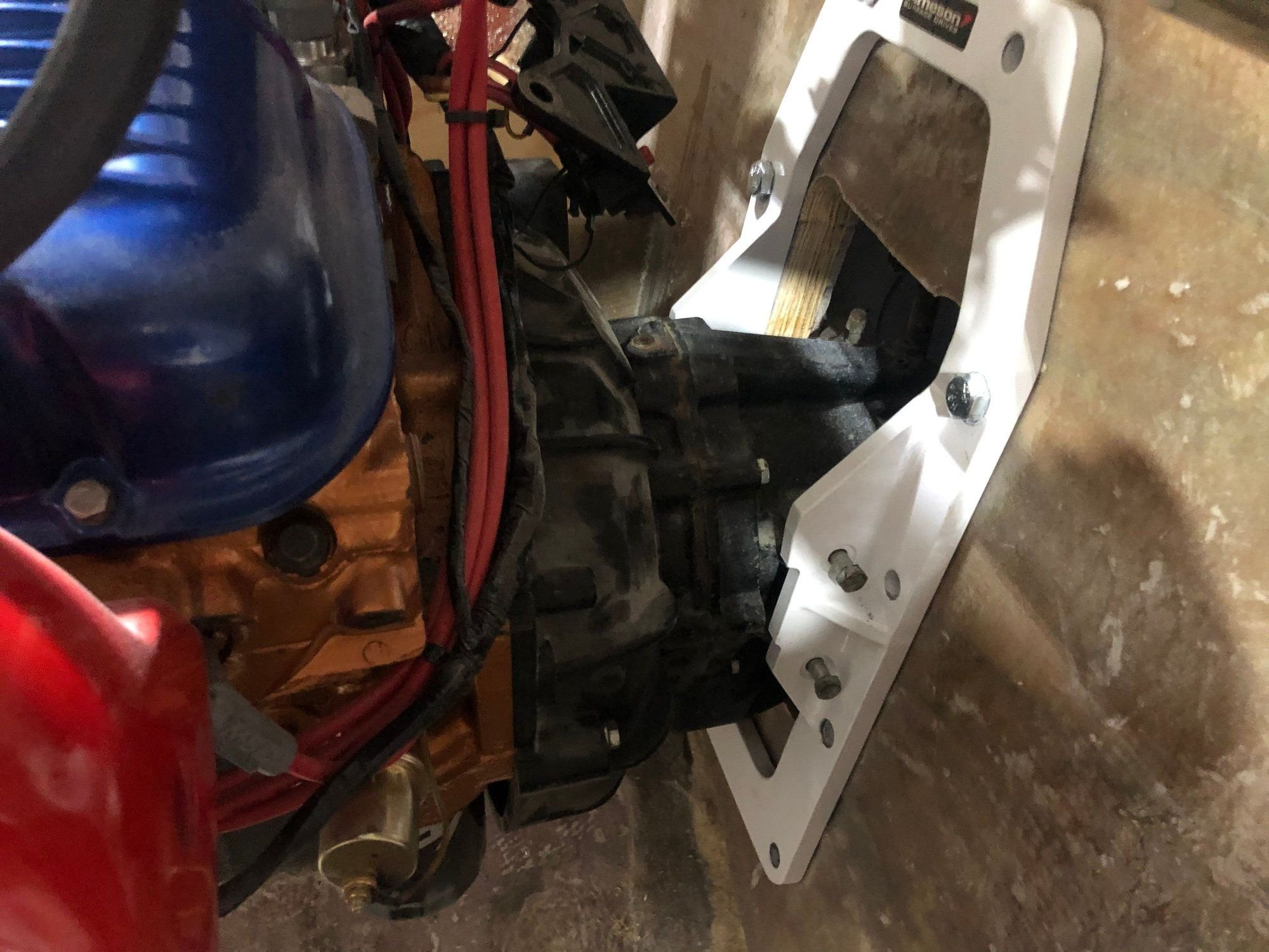

Originally Posted by Tartilla
Heath, do the trannys just fit into the extension boxes through the transom while attached to the engine? I thought they used the Bravo inner transom mount?
I need to move my engines aft on the Cobalt. So likely going to fab up extension boxes for the Arnesons.
Have you got any photos of the inner mounting system?
How thick is the aluminum on your extension boxes?
Engines are looking great.
I found these from about three miles up the thread lol. The transmissions sit almost halfway out of the boat.

Perfect...thank you. I should have figured you would have the photos...and check. Sometimes we get tunnel vision. Oddly...it was these photos that got me thinking on thoughts of moving mine back. I have the TRS bellhousings with the wing coolers and top mount starter. But I think they trannys would fit a bit into the transom. I need room to access the front of the engines...as well as move weight aft.

To be clear, I understood the Arneson ASS7 drive used the Bravo 1 inner mount and had the transmission mounted entirely in the post transom extension. I need to move my engines and drives aft...and I'll fabricate my own system to do so.
