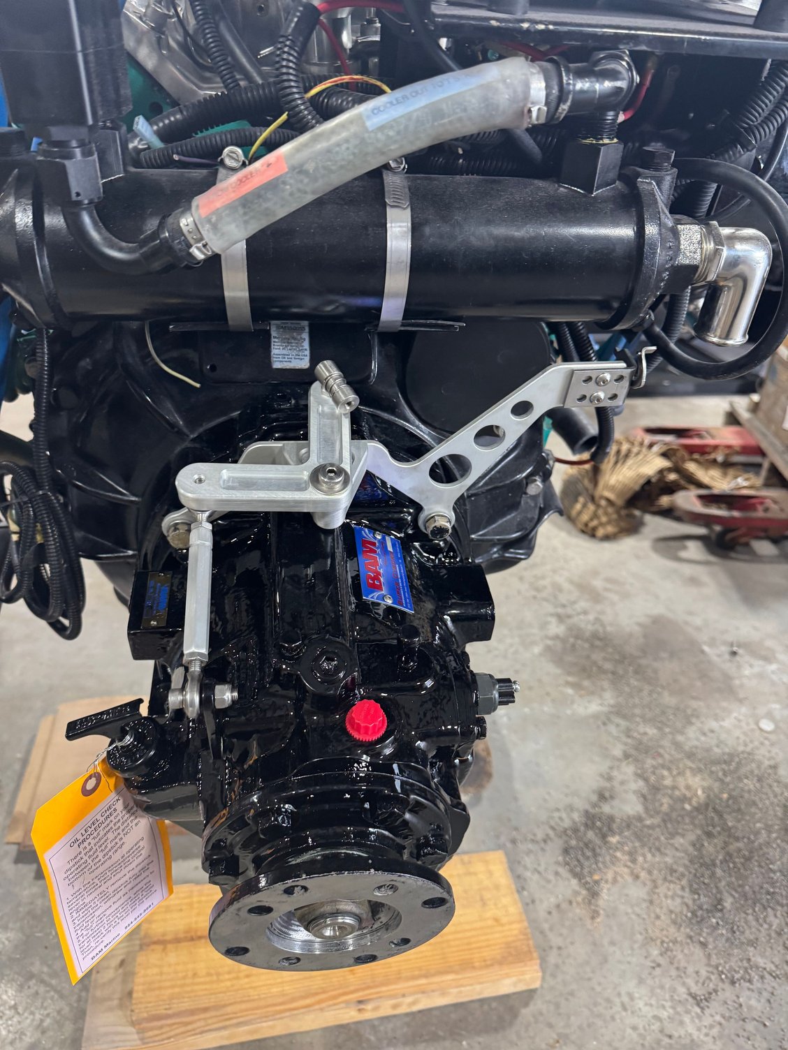

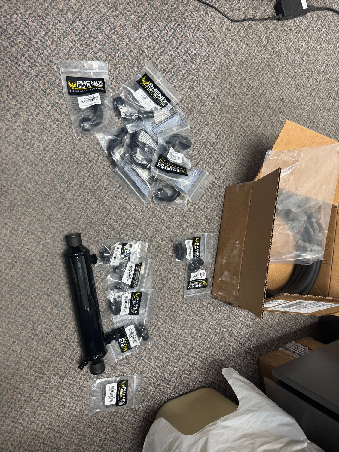

Getting starboard motor cleaned up and ready to go back in. We were running -6 AN hardware whereas -8 is the minimum spec on these BAM transmissions. So I’’ve upgraded to -10 now. Also my coolers were below spec. They’re also upgraded to larger units. Also we are adding shift linkage kits to be sure the shifters and the transmissions are synced up. All the hardware came in yesterday. Going to try to be back in the water this weekend.

Where did you get the shift linkage?
what do you mean by synced?
to what ? how can they not be synced?

I got the linkages from Marc at BAM. Apparently my arm was being over traveled when shifted into forward (arm was going past the detent). I was referring to syncing up when the helm shifter stick is bottomed out forward, to the transmission arm being in the forward detent.
