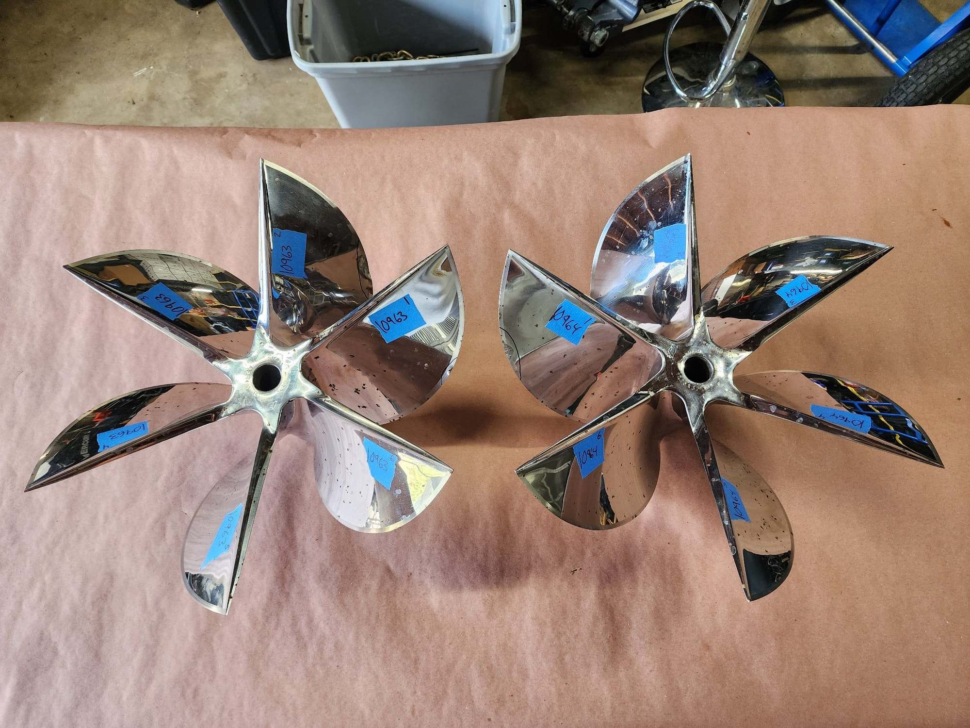

Thanks guys, I purchased some used 6 blade herring 17.25 diameter x 27 pitch x 16 rake, they are on the boat now, plan to run it tomorrow. I straightened about 3 minor bent edges and 1 decent sized one. They’re good enough to run. If they work out I’ll have them repaired. We’ll see.

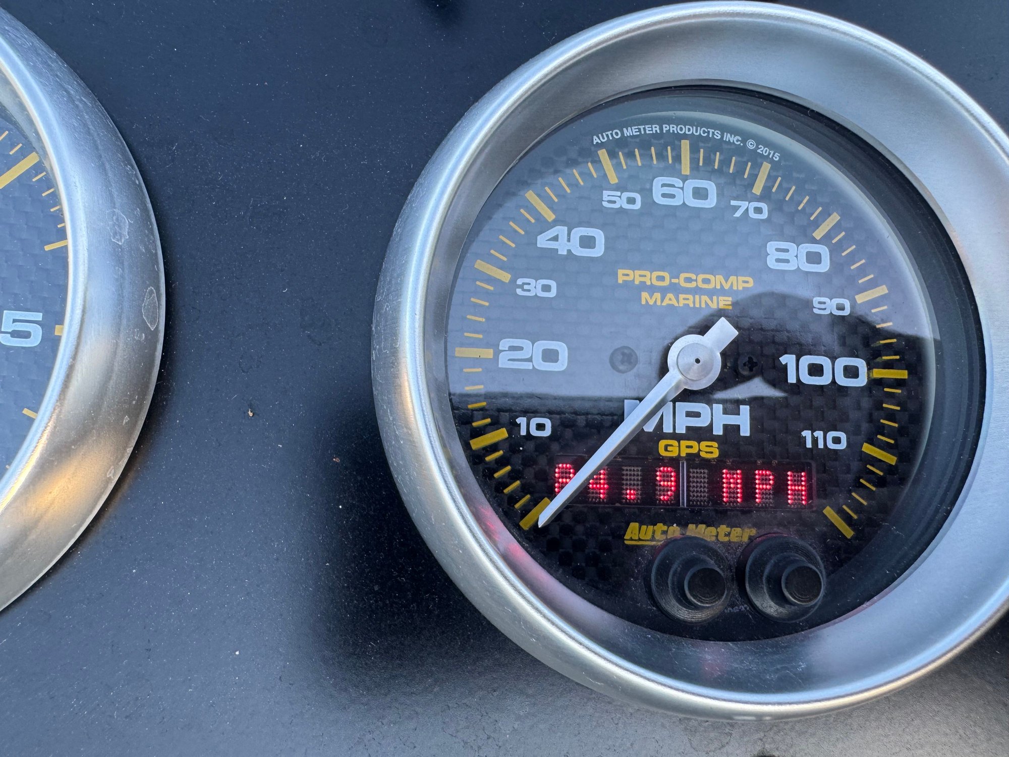

Boat ran good today, saw 87 downwind and 85 upwind. Shon cleared the more impressive number off the speedo before I took a photo of it😆 This is the first time Brian has ridden in the boat. He was a big help on those cold winter nights years ago we’d be doing hours upon hours of rot removal and glass work knowing the goal was a long way off. It was cool to have the three amigos in the boat.
