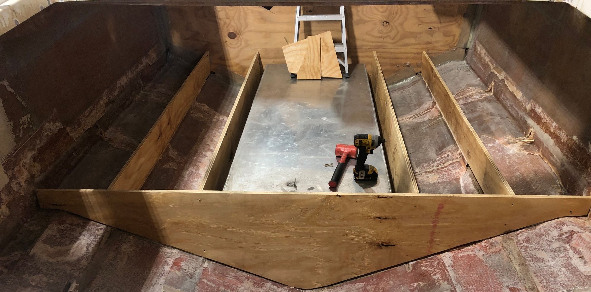

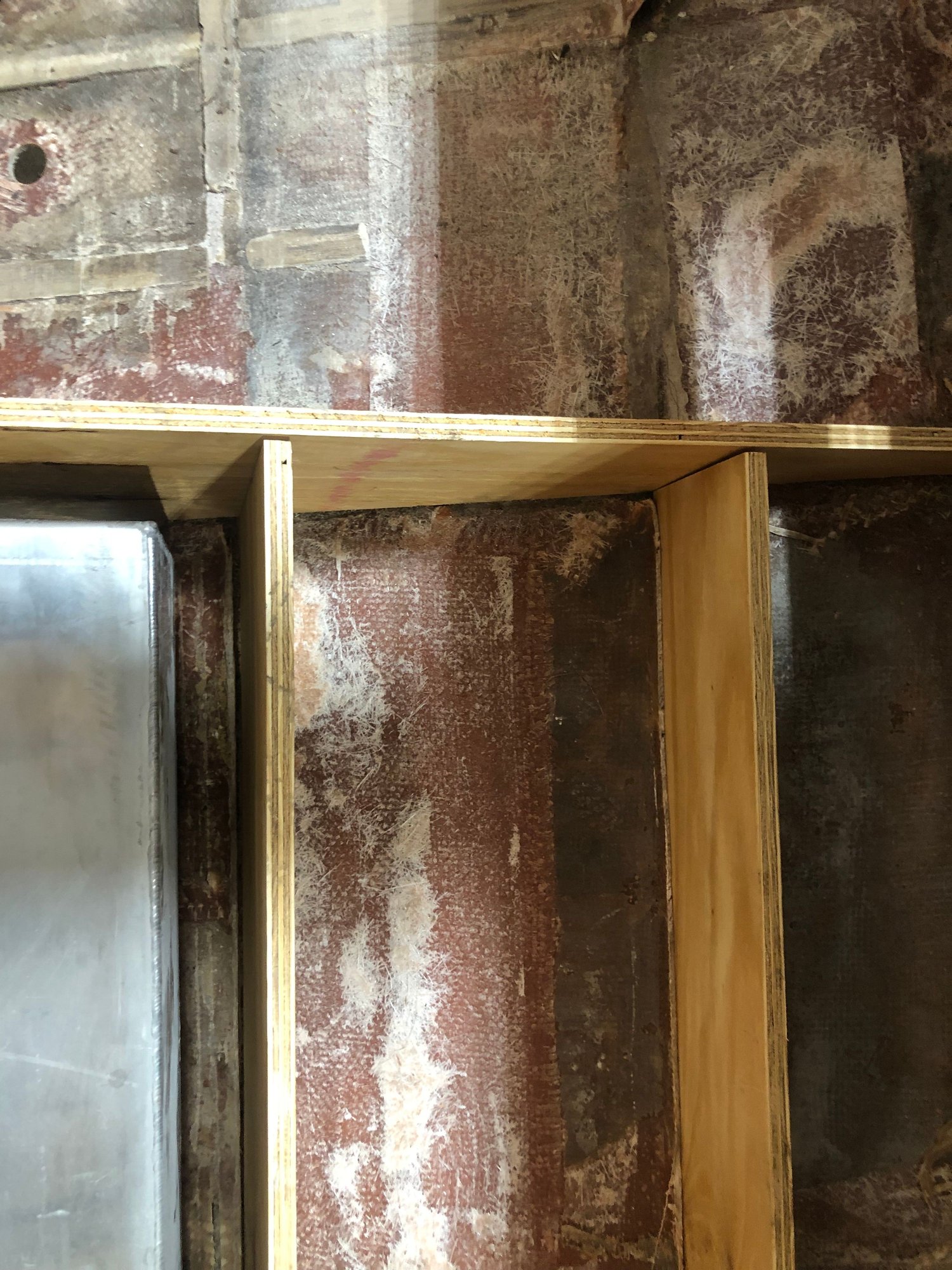

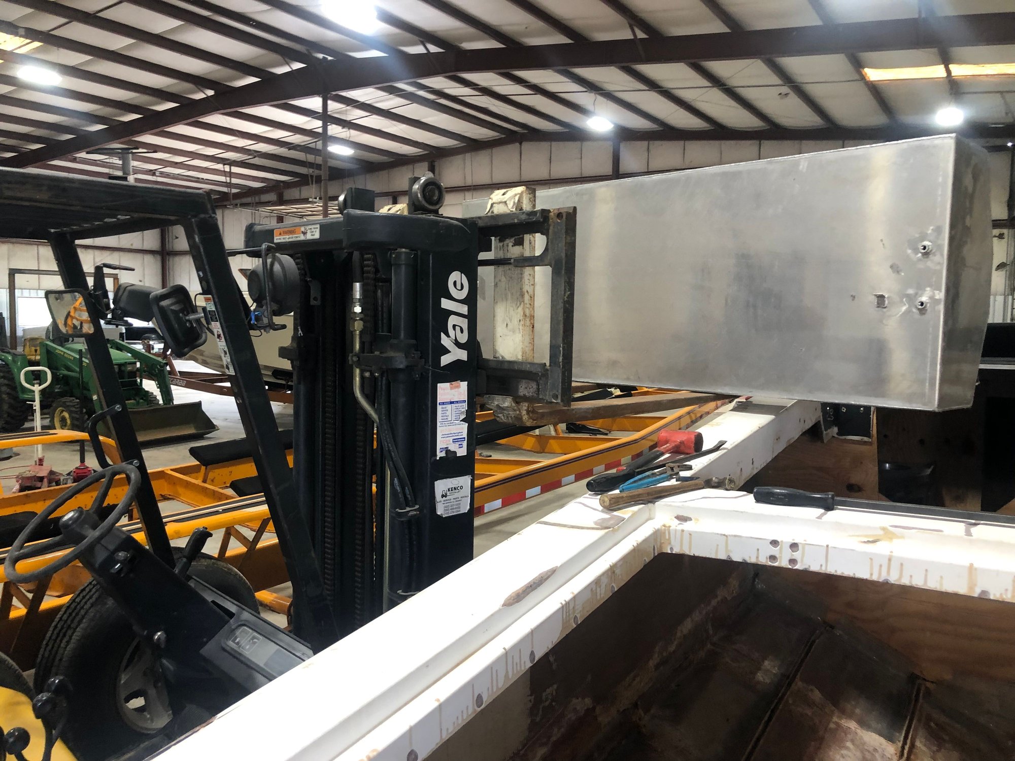

hblair 06-29-2019 06:49 PM
Got back on the 38 today. Was able to clean the inside of the hull, cut some stringers and engine bulkhead and fit my new tank.
https://cimg5.ibsrv.net/gimg/www.off...593b795d3.jpeg
https://cimg6.ibsrv.net/gimg/www.off...89907fa26.jpeg
https://cimg7.ibsrv.net/gimg/www.off...12f40336c.jpeg
jeff32 06-29-2019 09:12 PM
Going in the right direction ! The 30 is ready?

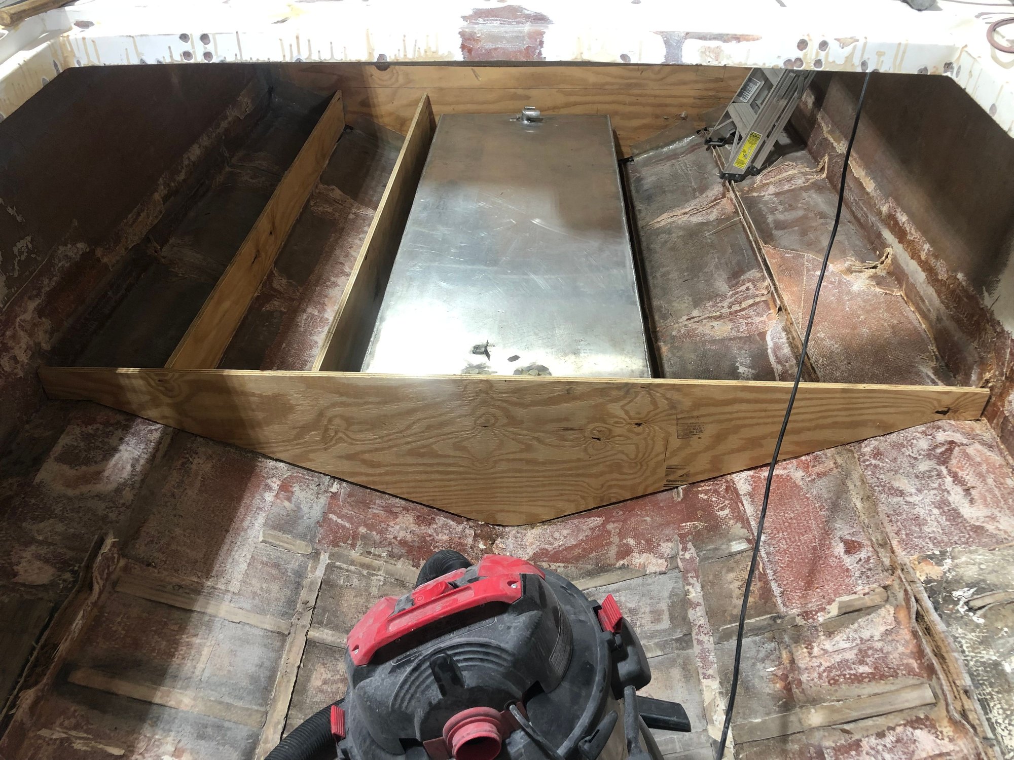

hblair 06-30-2019 07:41 PM
I’m done messing with the 30. I broke the left u joint on vacation a few weeks ago and am done working on that boat. I’ll be building the 38 from here on out. Got a little more done today. Gotta cut a few more braces and do some grinding and will be ready to glass the cockpit stringers and engine bulkhead. This boat will have a sealed cockpit floor and no drain holes in the engine compartment bulkhead.
