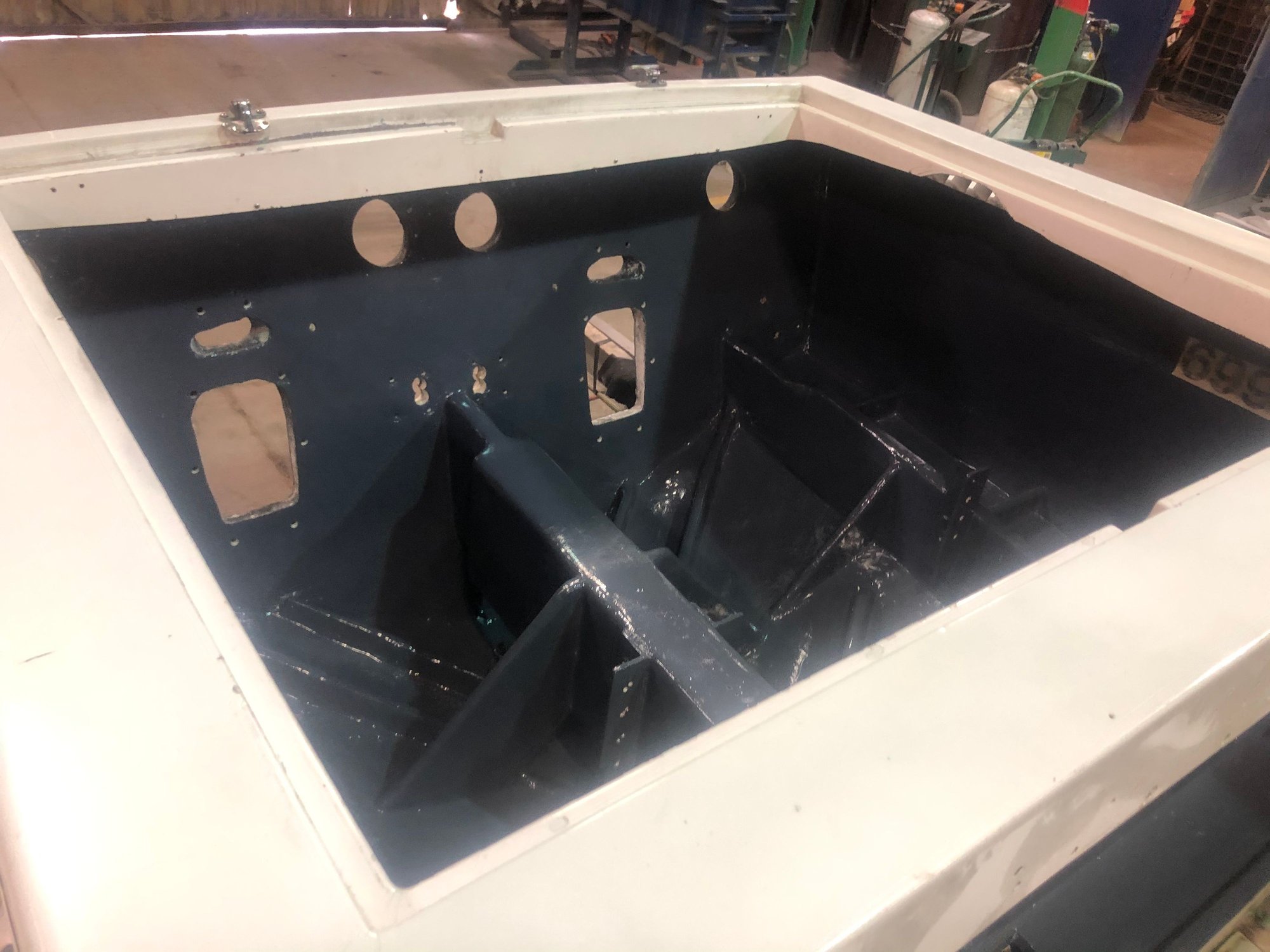

It’s not even close to what you have going on hblair! Yours is looking amazing

I just finished putting the last coat of epoxy in the bilge. I was really wanting to do black, but my plan unexpectedly changed. I ordered Total Boats bilge paint, with the understanding that I could tint the grey to black. If you have had that thought as well I’ll tell you that it is absolutely not possible. I want to be clear that their product is amazing and I’m not knocking it in any way, they were great to deal with. This pic shows the darkest it will go, it’s almost to the point of separation. Anyways I think I’m ok with the dark grey. I’ll start rigging next week I need to get a bunch of parts finished and make a couple decisions on how I want to deal with the rot I found. The Upulstry shop is almost 6 weeks out so I’ll probably tackle that myself just to get on the water for the season. I am looking for good info on bottom blueprinting if anyone knows of any good articles. I put a straight edge on the bottom and I have the opposite of hook? I need to fill up to 5/8” in a couple spots. I believe that’s the reason I have to keep on the planes so hard to keep the bow down
