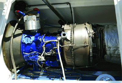

Likes: 165
From: Providence,RI
Here are some pictures of other Turbine installations.
Glad to know that I,m not the only Fruit loop
Attached Thumbnails Turbine 101-93fast2.gif   Turbine 101-amf_engine.jpg   Turbine 101-copy-2-ofdetroitinspection7-2-.jpg
