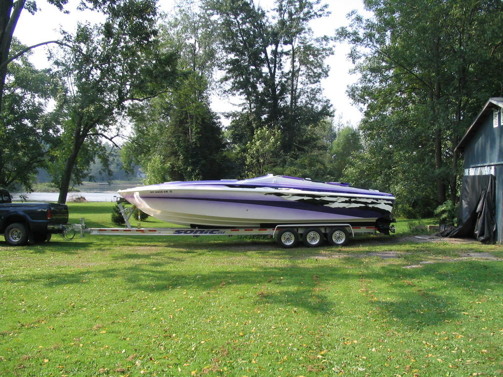

Have to ask...Looks like that is a shorter set up than I have on my trailer.Did you shorten that up yourself or did it come like that? Any close ups of the tongue of your trailer? May be interested in the same idea

The welder cut about 7" off the top of the winch stand support before welding on the mounting plate. It's setup so that the cable coming off the winch is even with the bow eye.

Asking about where your surge brake set up sits.Looks like it sets back father on the trailer.Like some one moved it in comparison to my trailer.
