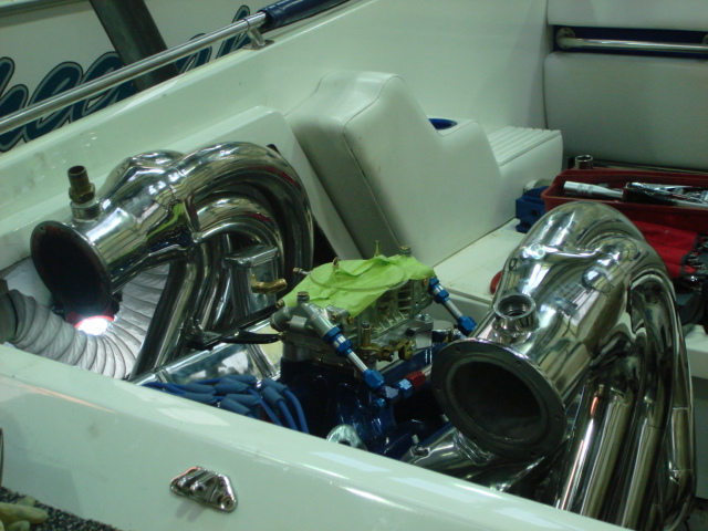

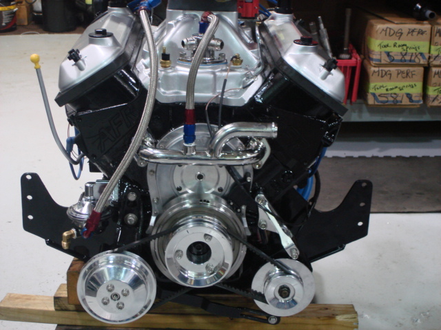

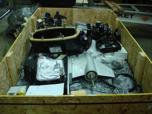

A few pics
Attached Thumbnails MGD Performance-dsc00207.jpg   MGD Performance-dsc00209.jpg   MGD Performance-dsc00208.jpg
