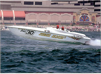

This hull never had bow lift trouble

this hull never had bow lift problems
