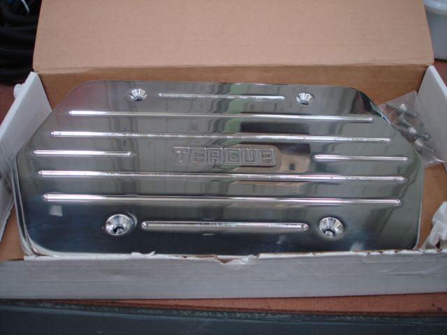

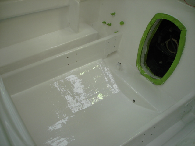

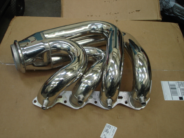

Hey rick boat coming along well,might be close by next weekend.Headers came in today cmi big tubes 2.125 id,along with billet battery trays and strainer,Teague makes really nice looking stuff and is great to work with.Got 3 coats of awl-grip in bilge looks nice,painted aluminum angle-motor mounts.Letting paint harden up a little and finish her up.Trying to do a first class job on everything so we will end up with one of the nicests boats around.

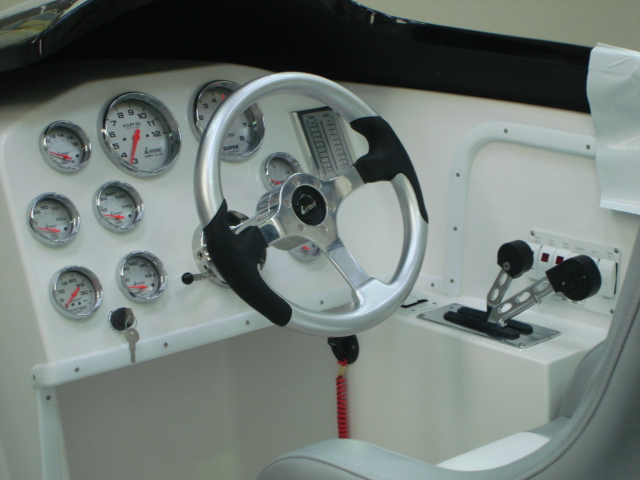

Some more pics
