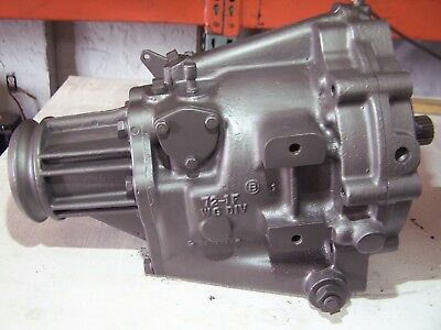

if you go stagger, I assume your going with a driveshaft, seems you will need a drive line input flange in the transom assembly as well as a different tail housing on the transmission with an output flange, with that being said and if true it would seem not worth the change
I'CE 11-28-2019 09:06 PM
1 Attachment(s)
example of a drive line transom assembly (#6) Merc. I believe yours are plug in style just like the old TRS transmission boats were, …. your using the Konrad 540z correct ?Attachment 576550
I'CE 11-28-2019 09:59 PM
1 Attachment(s)
example of flange style transmission Attachment 576551
