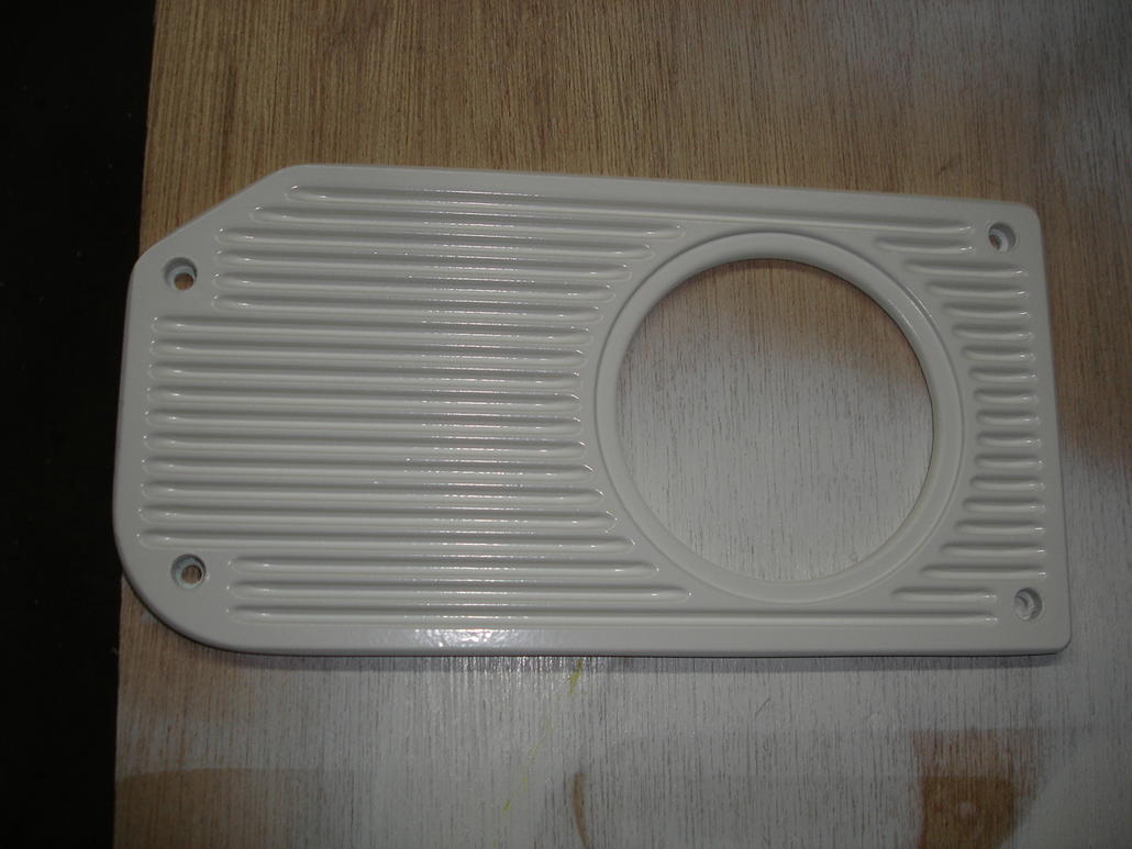

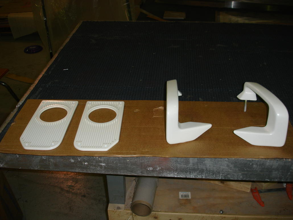

They are just siliconed in. Should come out pretty easily. Clean them up a little. Use a plastic primer (available at any auto parts store, used to prime the plastic bumpers and stuff on cars today) before applying any paint.
I did mine on my 91' 292, used the plastic primer, the gel was a match to Johnson outboard paint in a can, then used a couple coats of clear to top it off. Then just silicone back in.
Did the same to the grab handles and step plates also.
