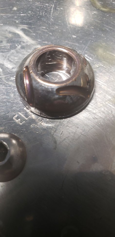

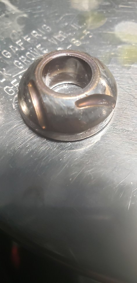

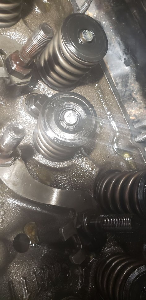

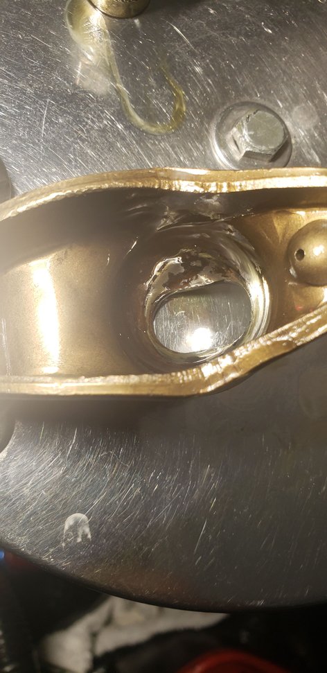

I pulled all rockers off...Some were not smooth with the ball in them and all were slightly discolored at the bottom. I believe I have a oiling issue still. I am using stock valve covers with drippers.
