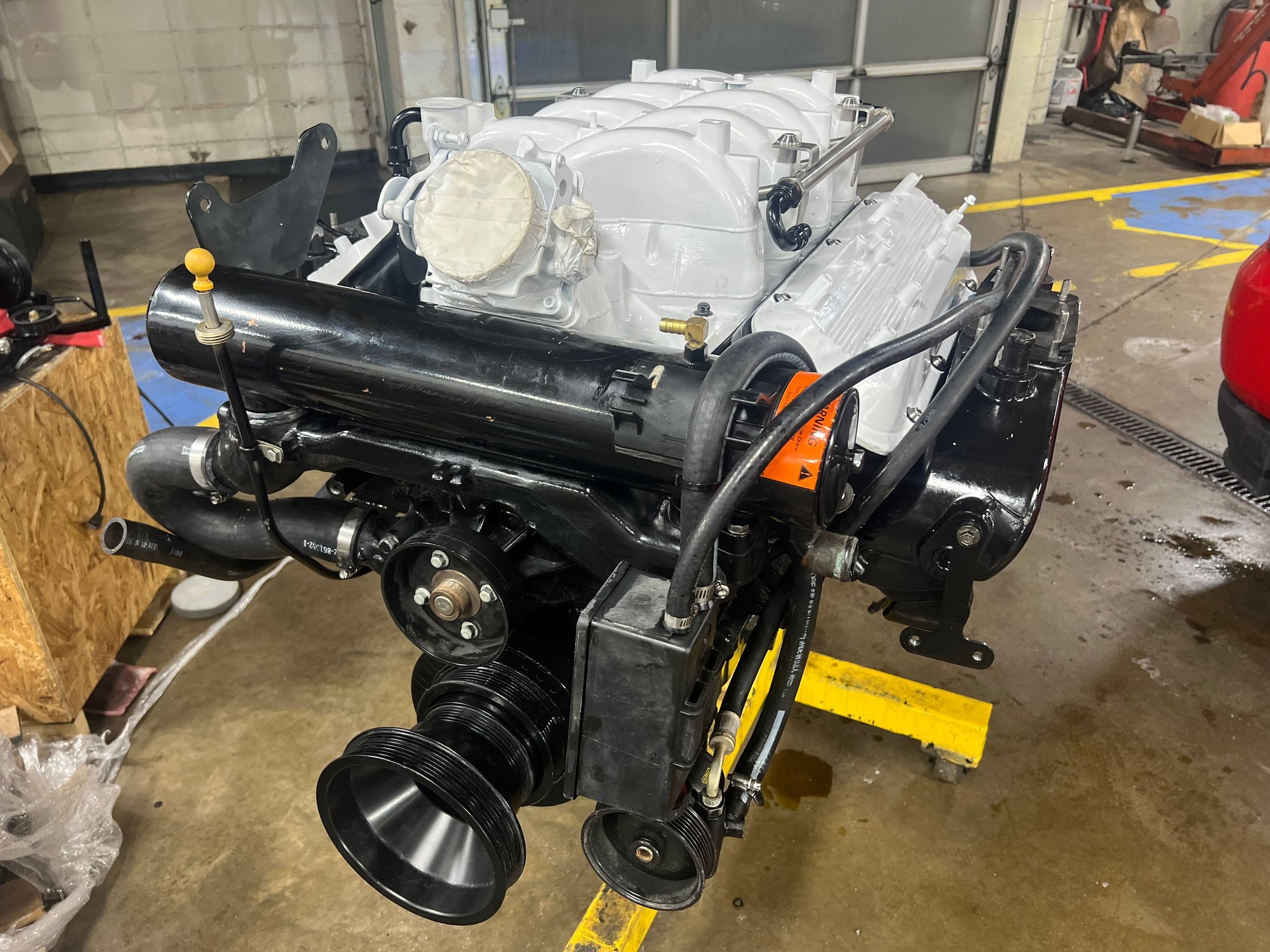

Got the fuel rail on and the harnesses connected. I made a set of riser sleeves for the ignition coils, to get them away from the valve cover heat and give us room to tuck the harnesses underneath. I reloomed the injector harness with new cable management webbing, using rescue tape to secure the ends/openings. Gonna do the same for the ignition harness, as the old shrouding was heat cycle baked and crumbling.

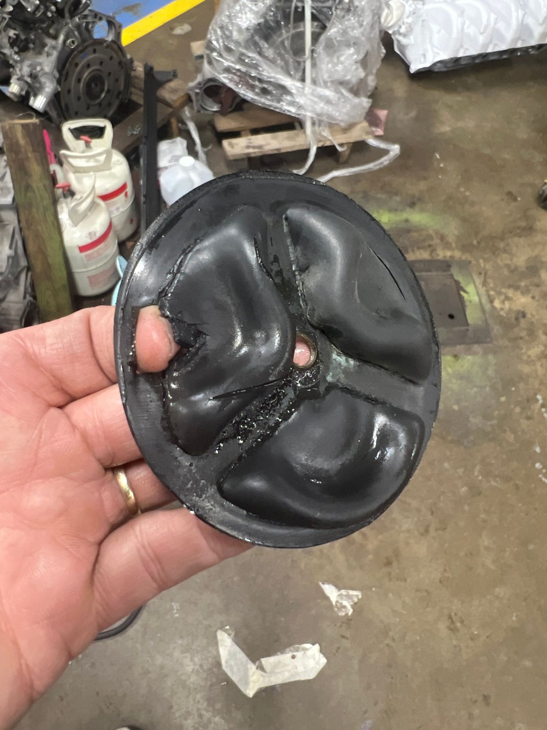

Made a grim discovery. I poked the hole in it with the screwdriver, but these heat exchanger seals are toast; literally falling apart in my hands. I ordered all new rubber components and the heat exchanger will be good to go and final installed.
Pretty much everything else is hung, as far as the peripherals, except the ProCharger. I need to pick up a new serpentine belt, as I have no idea how old the one that came off is (I haven’t changed it since buying the boat).
A glimpse at the exhaust riser plumbing. It got a bit more complicated than I had planned after putting the concept to reality. I can make it all work, and it will be free flowing, but it’s definitely gonna be a conversation piece. Now I just gotta hope it’ll actually fit under the sundeck (I’m 95% sure )
The builder is going to build a run stand. Nearly 50yrs of building engines on a hobby basis, and he’s always just dropped the engine into place and fired it up. But he’s decided a run stand would be cool, so my engine is gonna be the guinea pig for it. I picked up some 2” box tubing and he’s gonna get to cutting and welding. He’s got all the components for a proper run stand (starter, fuel pump and regulator, etc). It won’t be long. He’s saying a pre-run engine in the boat before the end of the month.

Are you going to run it on the dyno to get numbers and a base tune?
