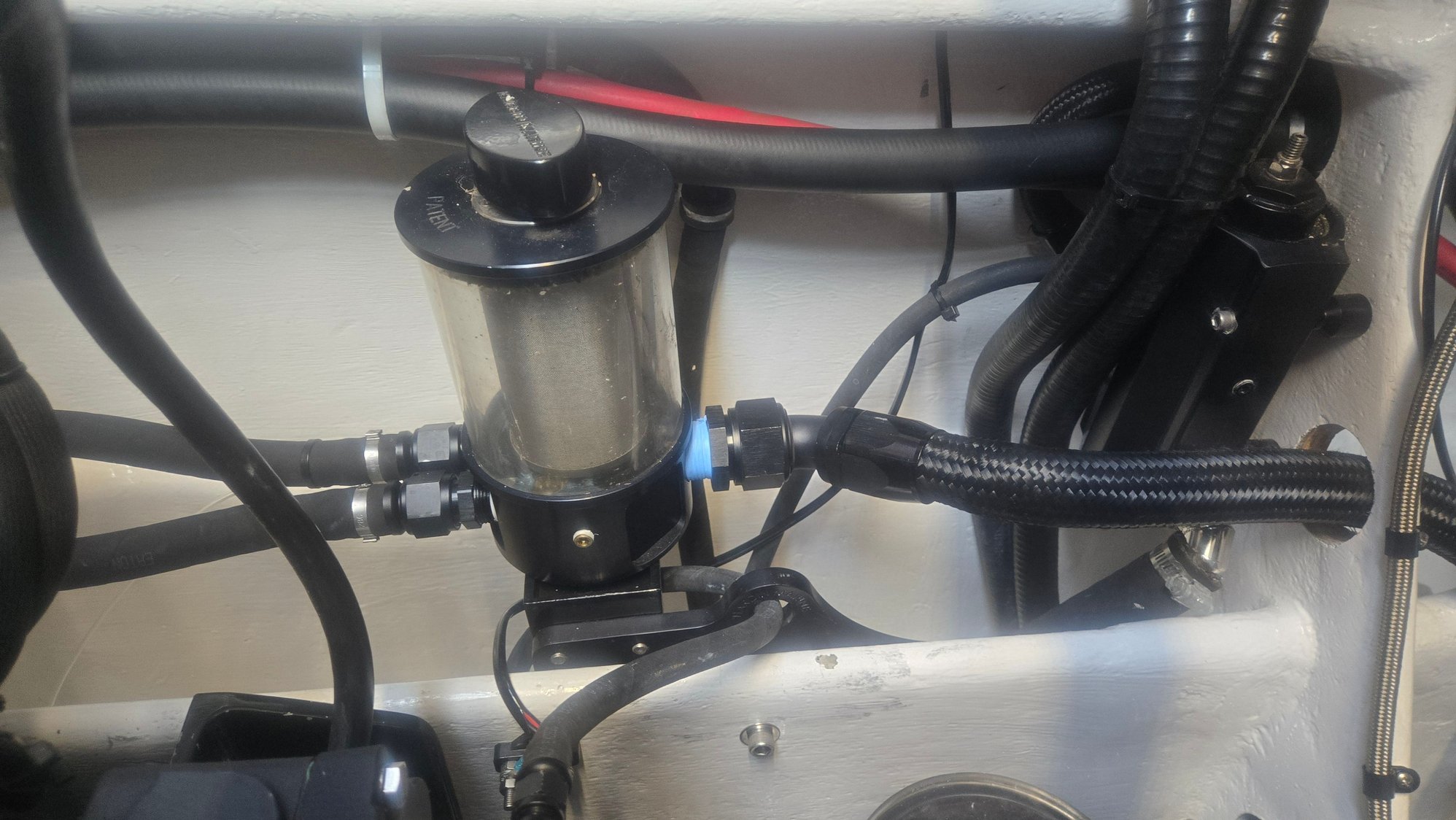

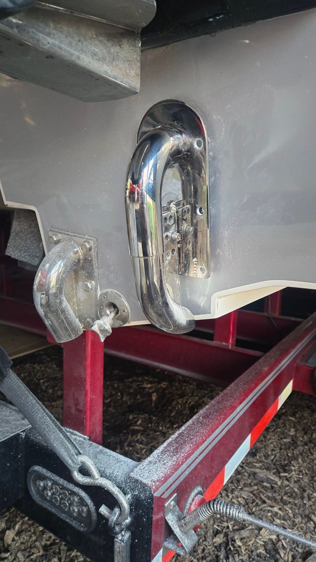

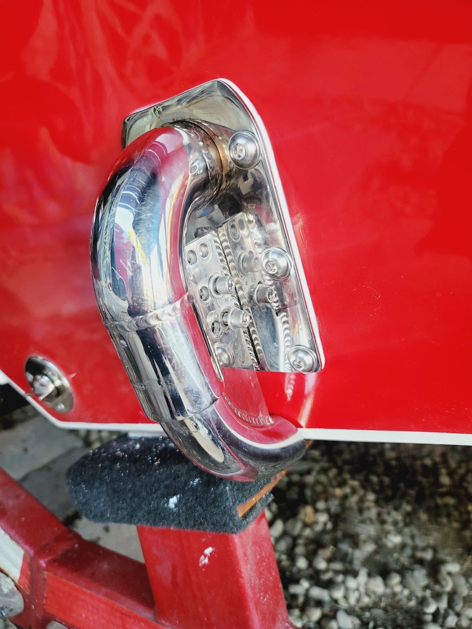

On the cig I actually ended up cutting the bottom of the pick up more 'straight' instead of the big scoop.. the scoop really pack in the water even when just a bit showing below the hull.
On Bad Kitty I got rid of some useless trans temp gauges and replaced with intercooler water pressure.
Used this strainer.. last engines they were mounted on the head which is even nicer but I don`t have any room on the new ones.

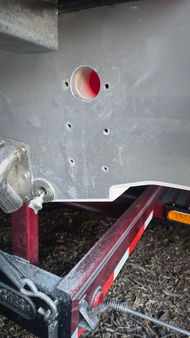

The reason I made the angle cutter was to achieve a consistent gap around to pickup tube for the 3M adhesive. I first cut an oversize hole with a hole saw then filled it with fiber reinforced epoxy, then machined it to accept the pickup tube and adhesive. Overkill I know, but I can't help it.
