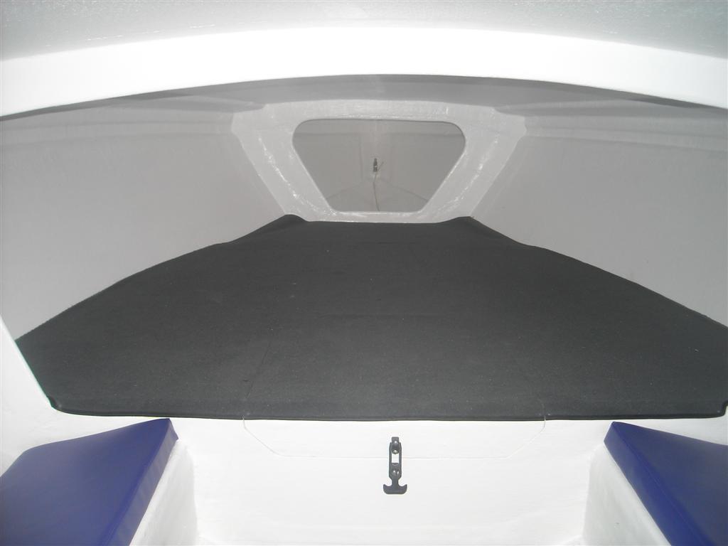

Some more progress. Before and after shots:
Attached Thumbnails Kryptonite project begins....-kryptonite-026.jpg   Kryptonite project begins....-kryptonite-040.jpg
