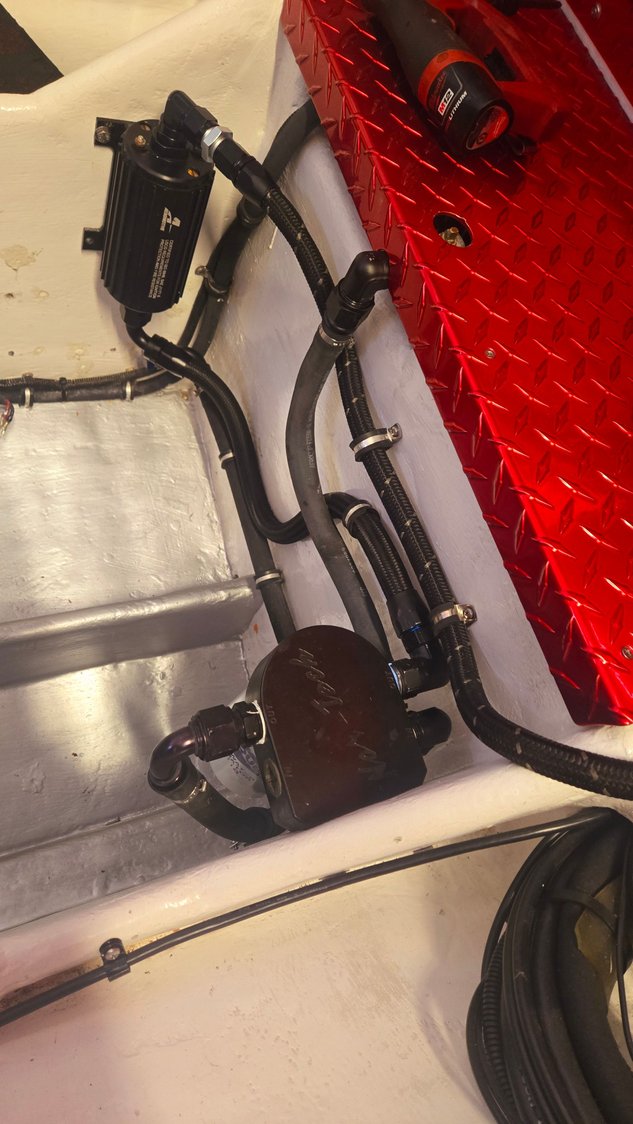

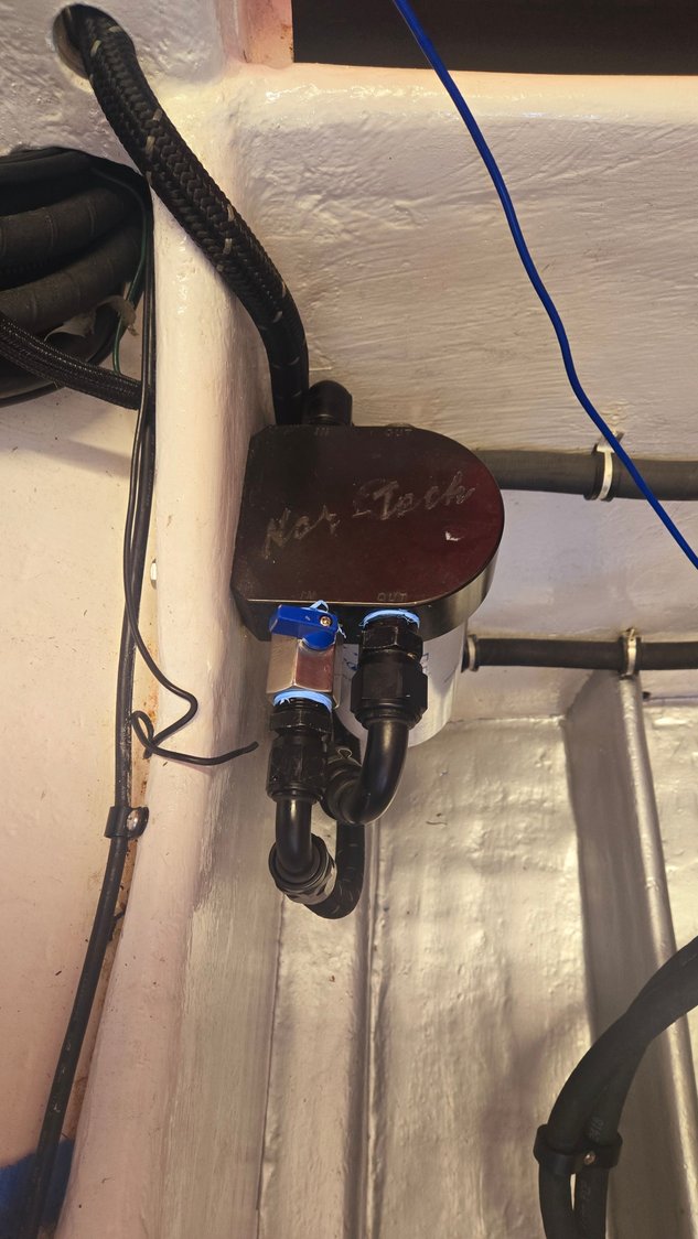

She`s a tall ***** and a pain to fill up so I put a fuel pump on the port tank that will pump the gas from port to starboard tank , now I wont have to move boat at the gas station. #winning
Will that pump move the fuel as fast as the fuel pump is putting it in?
No.
Average gas station pump is 8-10 gallons/minute
The pump moves 3gl/minute at 50psi pressure . There`s no data on flow at 0 psi.
My testing it was about 5-6 gallons/minute so about half as fast.

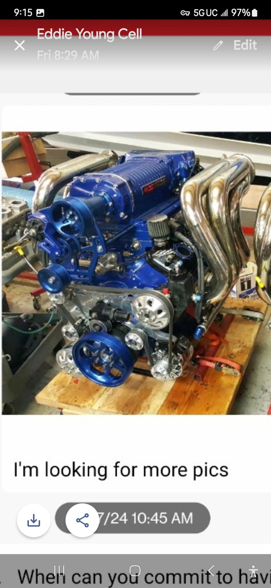

Originally Posted by Stuckonstupid
Just curious how these Eddie Young motors compare to the motors in your old cig?
Parts wise or ?
Eddie has a recipe he`s been doing for a long time , one that works but the tune and the way he tunes the engines on the dyno is key imop.
He puts em under much a lot more stress than anyone could in a boat . then tunes every few hundred rpm under a ton of load. If they don`t knock on the dyno they never will in the boat .
Not crazy about mefi-4 but the dual knock sensor protection is way better than even what Holley can currently do which is a plus .
Parts wise :
Merlin IV block
Billet caps
Lunati crank
Howard billet rods
Belt drive
Shaft rockers
55mm cam
.904 lifters
Brodix BB3 X CNC 380 heads
Custom sheet metal oil pan
4liter Whipple
Moac intercooler
Distribuless ignition
LS coils
Crank trigger
ICDEDPPL is offline
Old 11-02-2024 | 10:47 AM
  #108
Joined: Jun 2007
Posts: 7,345
Likes: 1,850
From: Merritt Island, FL
Can the Whipple's be ordered black?
Wildman_grafix is offline
Old 11-02-2024 | 11:00 AM
  #109
Joined: Jun 2009
Posts: 9,990
Likes: 6,484
From: Chicago
This build is 50/50 new/used parts .
I picked up a rebuild someone bailed on midway.
These are not brand new builds, I wouldn`t be able to swing that lol
The blower and all the pulleys are blue .
Eddie gave me a price that was hard to refuse .
Love that guy .
