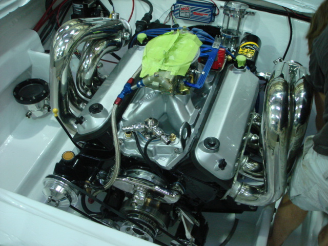

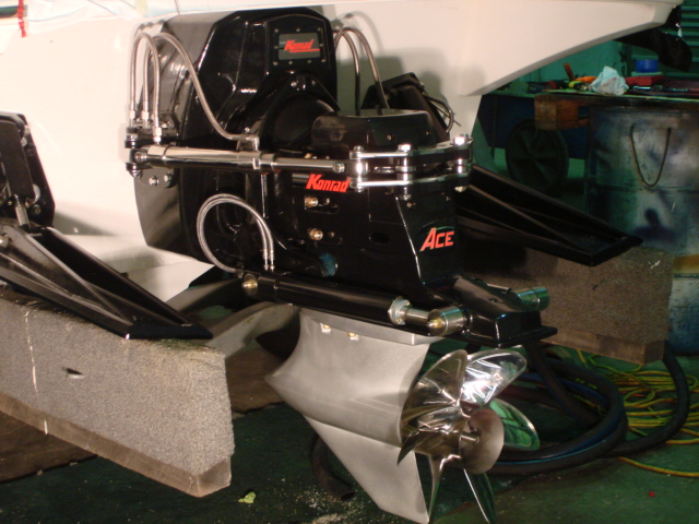

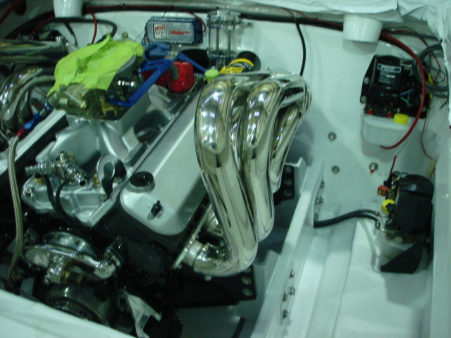

Got engine in boat,cmi big tubes clear hatch,started ruffing in the rest of rigging won't be long,not sure if tailpipes i got from teague will work the water fittings not indexed right,will give him a call tommorrow.The herring 6-blade will be the first test prop,I also have lab finish 5-blade hydo 15-29 if those don't work i will try bravo1 32.

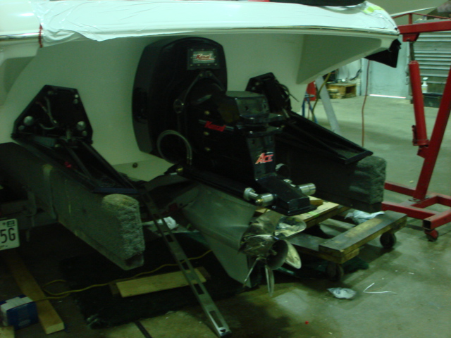

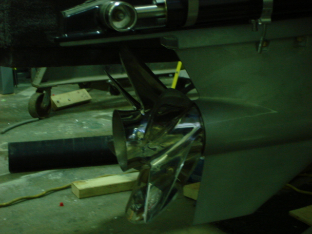

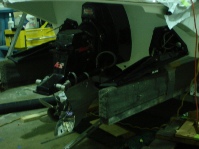

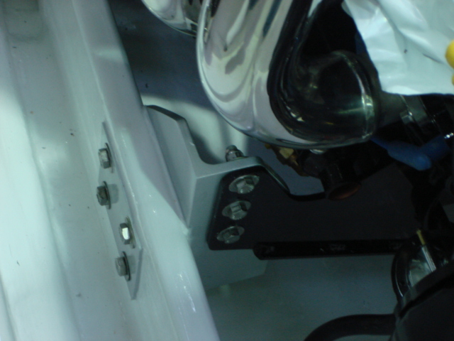

Got outdrive on,that Konrad sure looks nice on that extension box,had to check out herring 6 blade,leading edges sharp as razor blades.The diameter looks like 15.5 gives me about .25 tii blades hit cav plate,checked prop height right on 2 bellow.Rick we will be in water soon to check out new bottom,maybe this weekend,going to finish steering tommorrow and finish rigging batterys,not quite sure if i am going to use the tails i have,Bob teague was at the powerboat trials and won't be back till thursday,every thing else going real well,the boat has alot of room in it and is nice to rig

Making progress,the k-planes are mounted as per johns specs ,they will clear konrad without cutting them,going to cut exaust holes tommorrow and finish some rigging,waiting for a couple of fittings,if everything goes well going to splash this weekend,have to run a couple of customers boats friday if weather permits
