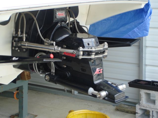

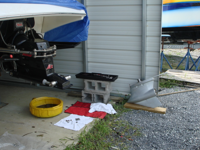

One thing to understand is that the merc 525 is rated at propshaft ,crankshaft hp on the merc 525 is usually dyno at around 560-580 on most dynos,the other thing is that when you add hp you gain not only top end speed but acceleration which makes the boat feel fast and a lot of more fun to drive.I ran the boat with 1 spacer,did not like it lost a few mph going to take it out,the boat seemed to handle the rough water a little better but seems to run the best with no spacer p5x 29 5900rpm around 93-94mph with killer acceleration and a outdrive that will handle a lot of abuse.It would be nice if i could raise drive up 1 inch and see results,the trim felt the same with spacer only dragging more unit in water.The new bottom must lift well without a lot of trim leverage which should allow a higher x-dimension than the old hull.Next on list is going to let brett at b-blades build me a prop
