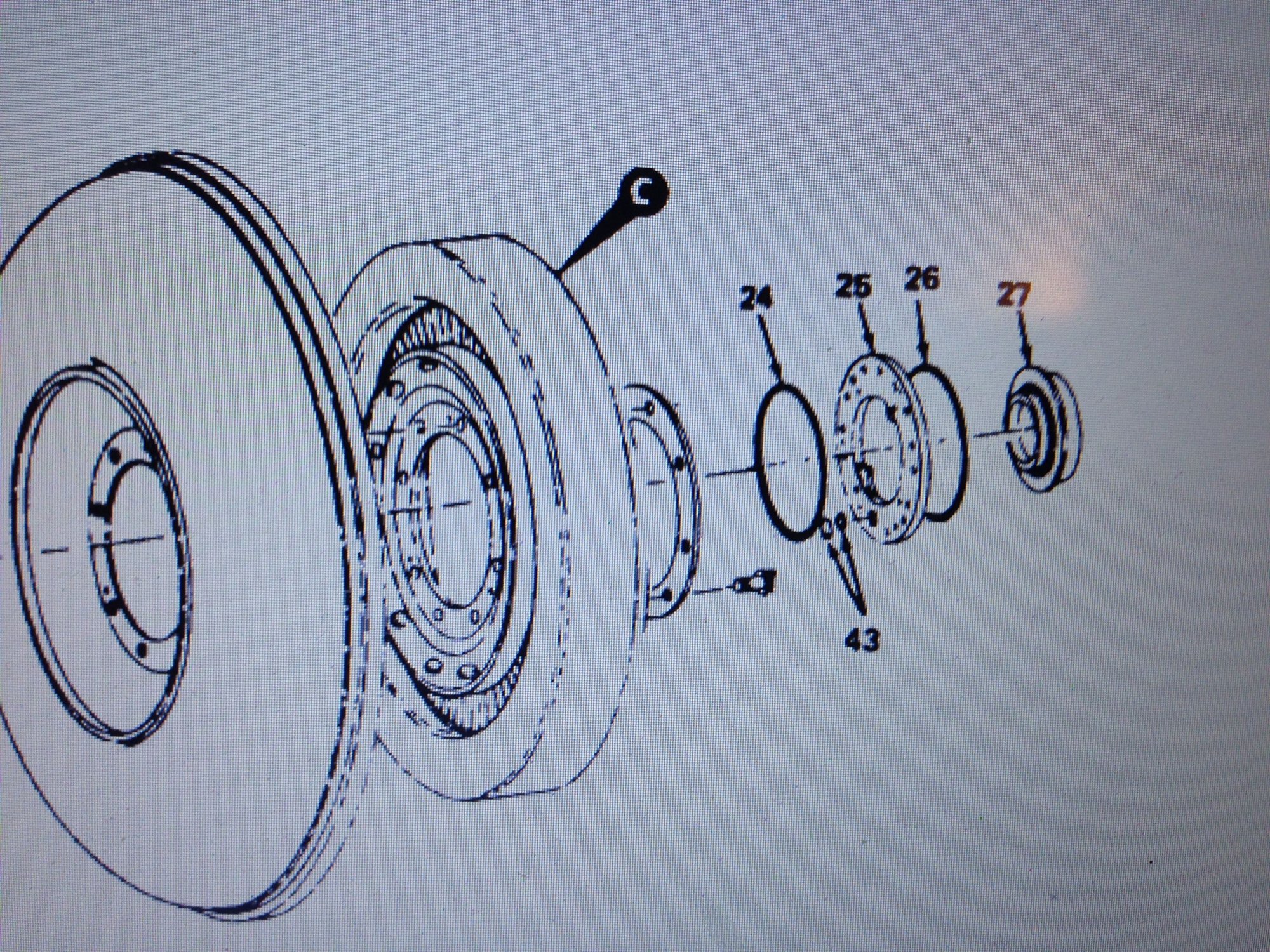

ah..I see where this is from post 160...bad stuff happens fast at those rpms....looks like SPS is an aftermarket fastener supplier..

Yes

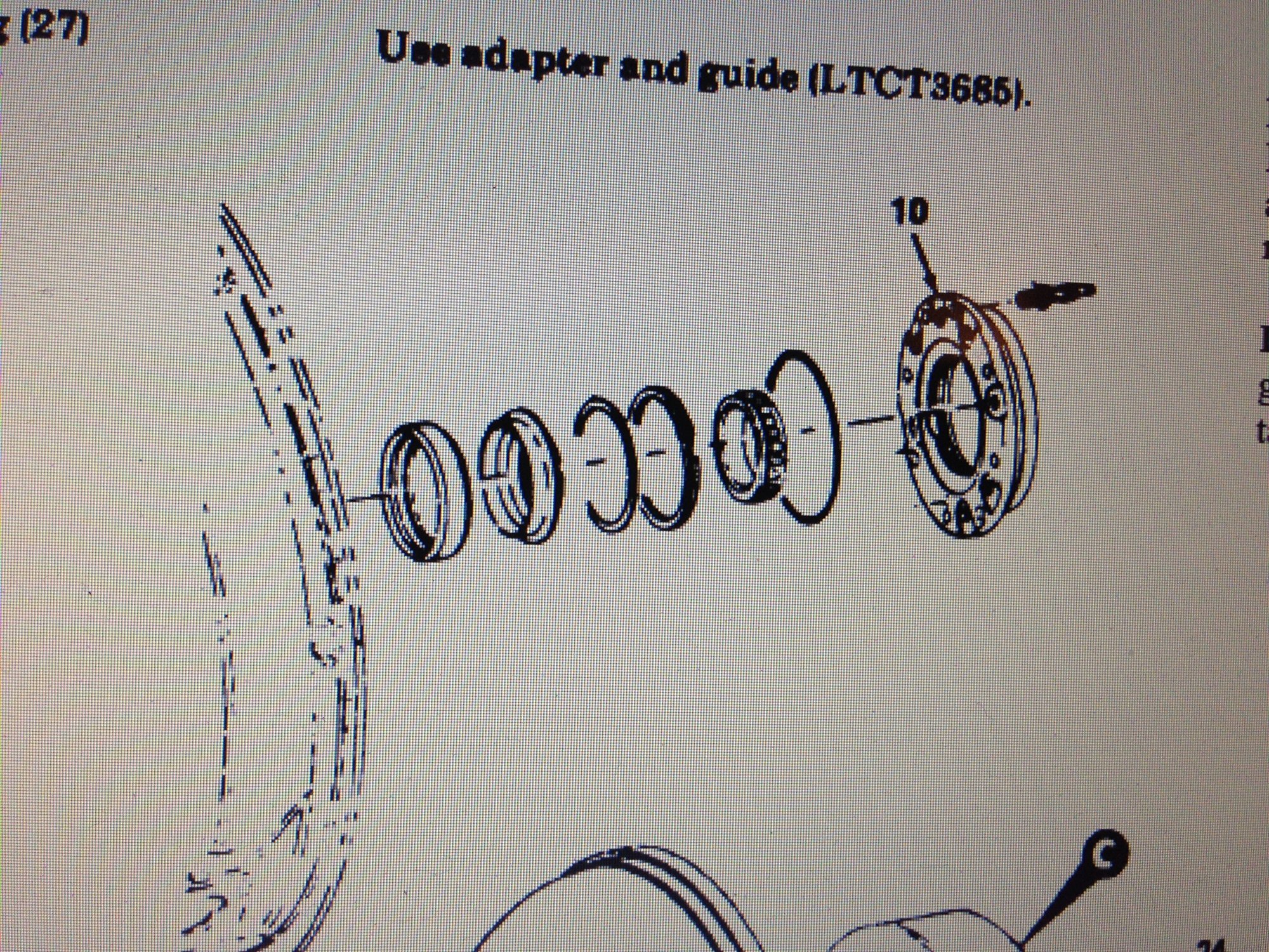

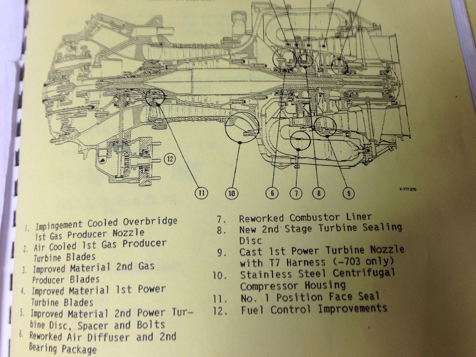

here are a shots from manual
showing 13b and yelow pic 703

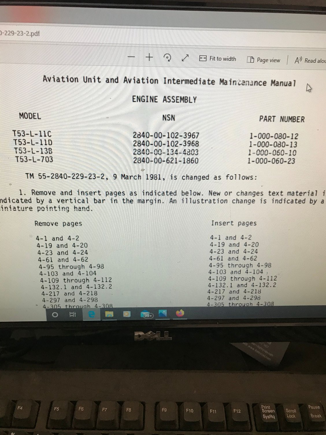

Here is some different models and variants
i think there is even some more not listed

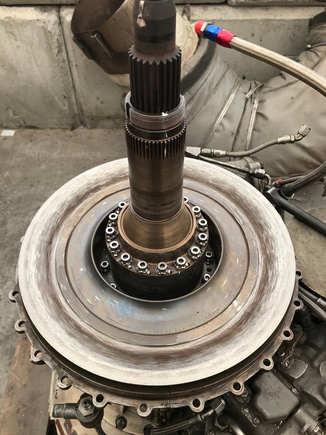

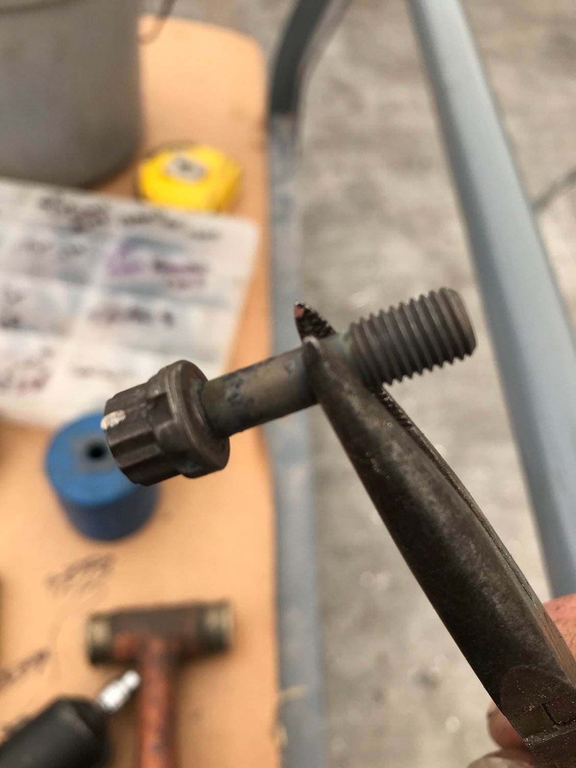

More then one was fractured
See the crack
All new ones Jim overnighted all the parts!!! 200 inch pounds in shaf 180 on centrifugal

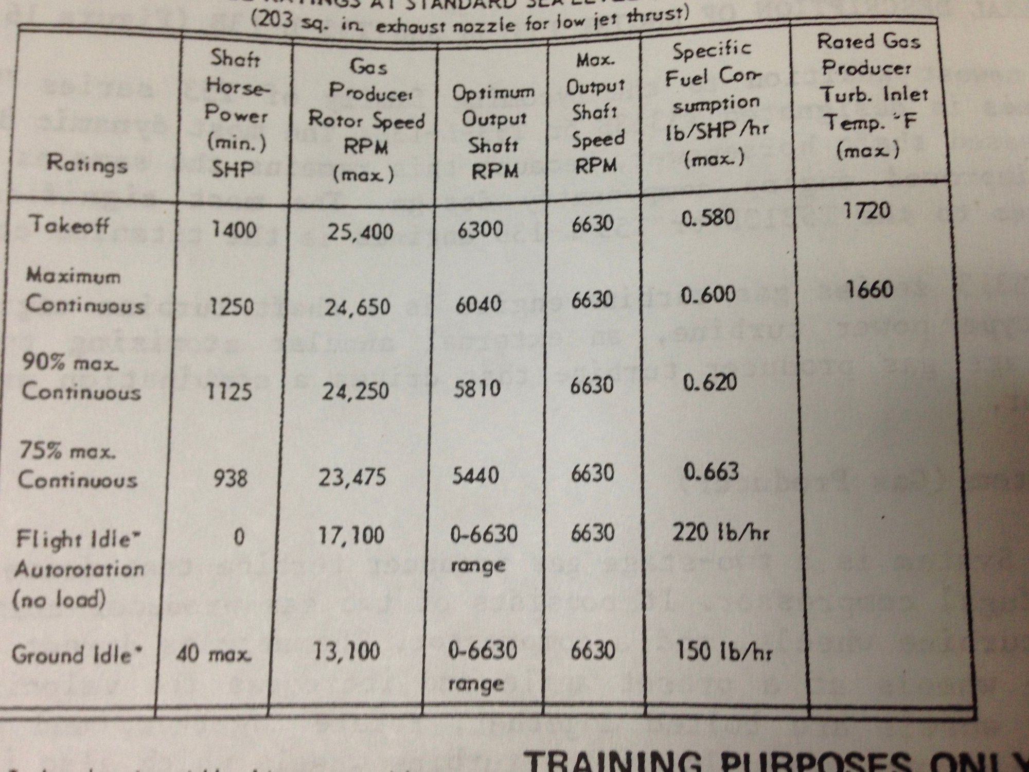

how much hp and tq do these make?

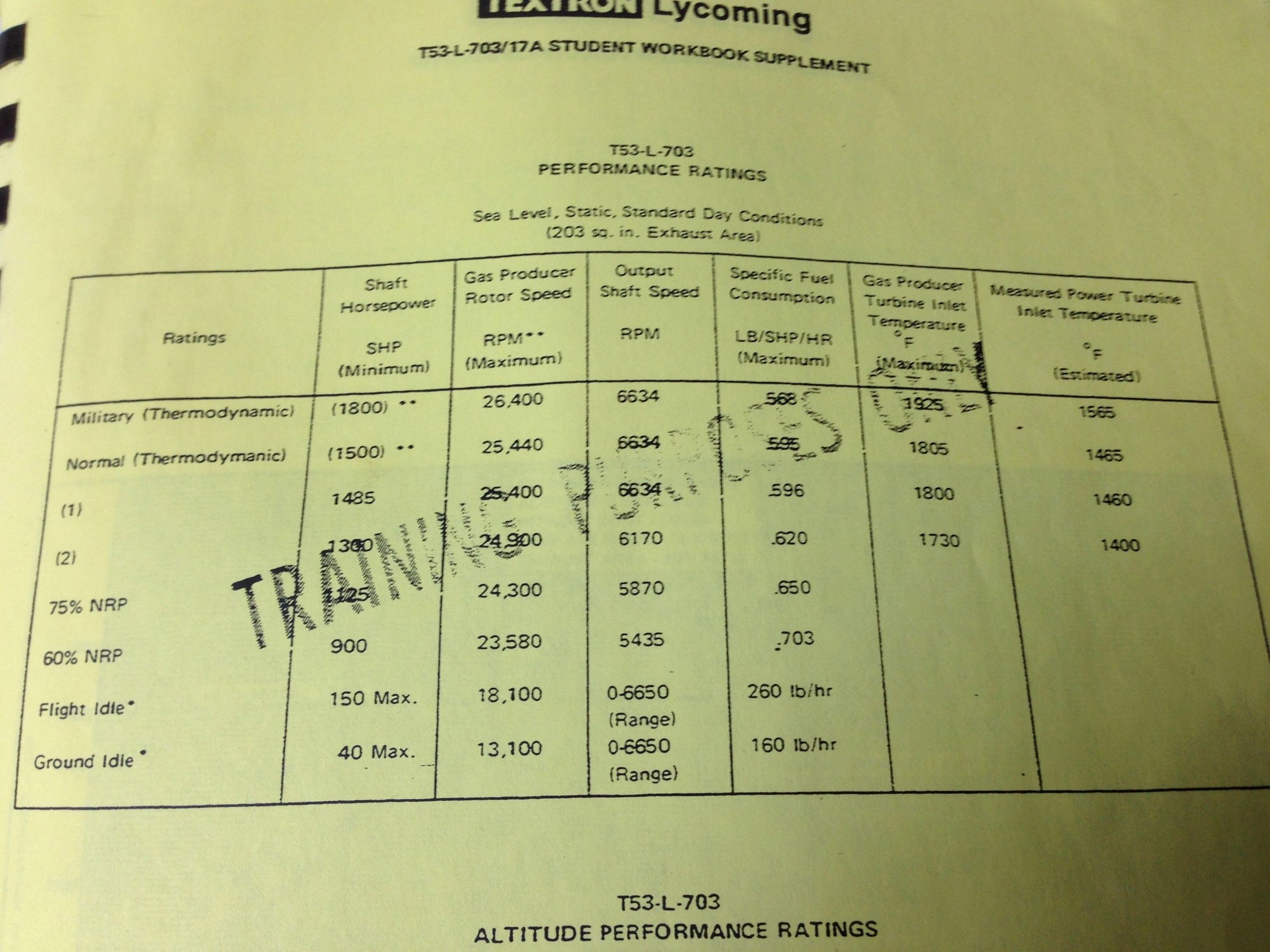

i have test cell sheets from pps
before we converted to the hybrid
703.s in 2013
This is the 13b
This is 703
KNOT-RIGHT is offline

Post 503 shows the torque chart,

so your military rated. and now I see why those turbines are thirsty,sfc's are high.
