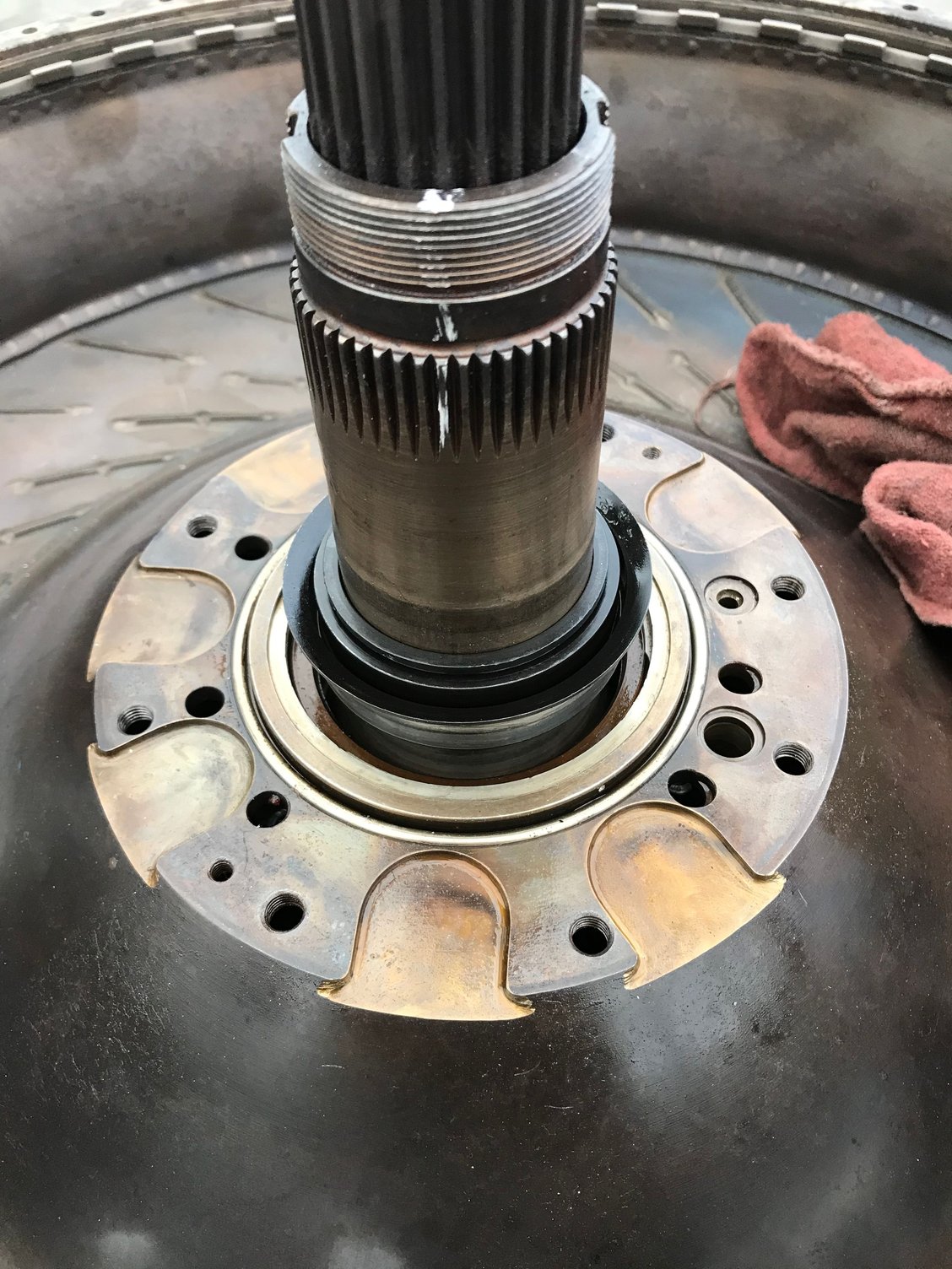

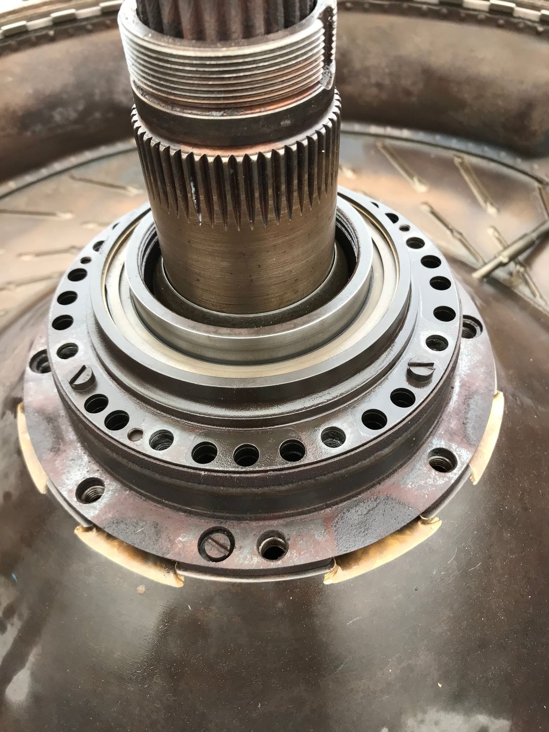

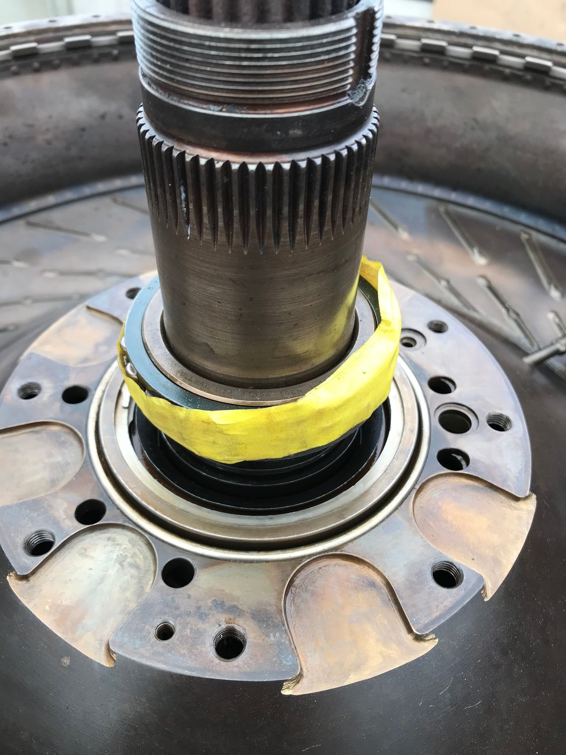

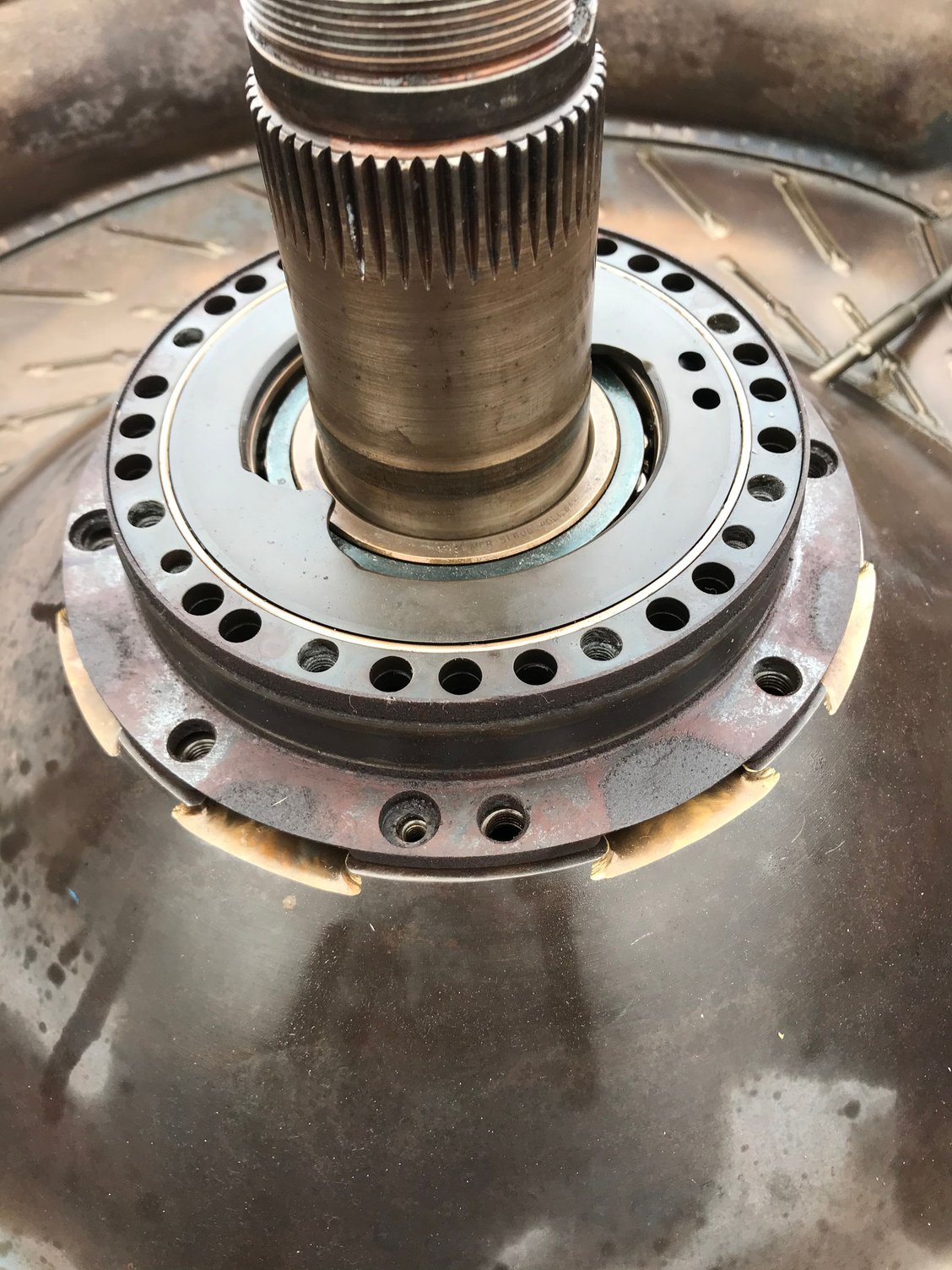

Ok here you go Install diffuser Install seal retainer
Install roller bearing Install three new crush seals
Carefully install bearing retainer Pinch plate assembly Take note on oil feed and return oil Holes match up Gently tighten the two flathead Screws
Install the cone and seal taking note On shims

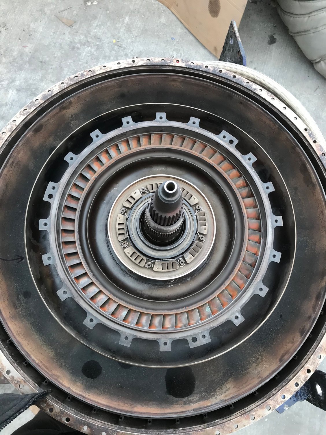

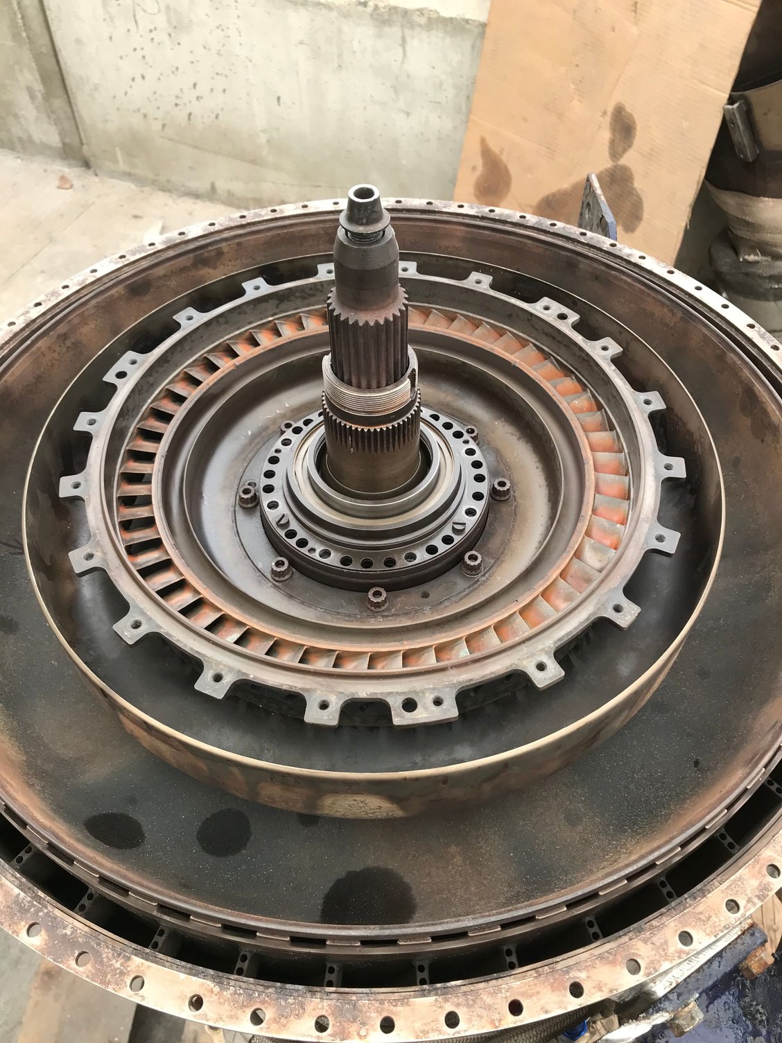

The impeller bolts 160 in. Lbs. rear shaft 200 in. Lbs
Now install deflector and first gp nozzle
then install the louvered sealing disc

165 inch lbs on the 6 bolts Holding deflector
and gp nozzle
110 inch lbs on louvered sealing disc

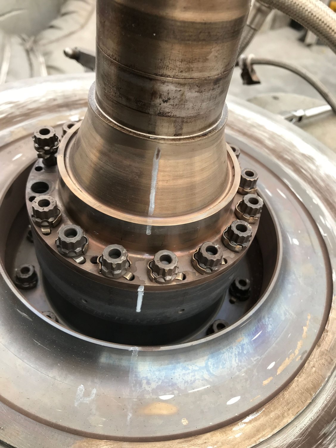

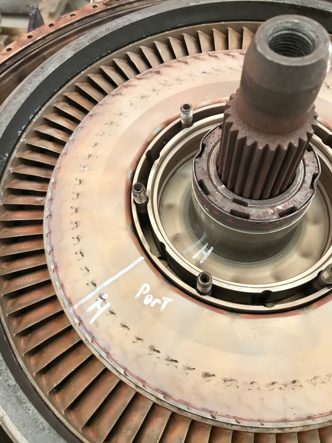

Backing up
when installing the two gp rotors
install them 180 degrees from the
compressor heavy marks
Rotor heavy marks 180 out from compressor
Compressor heavy mark
KNOT-RIGHT is offline

Its kinda hard to believe that those marks
are still there from 2007
thats not done with a crayon
