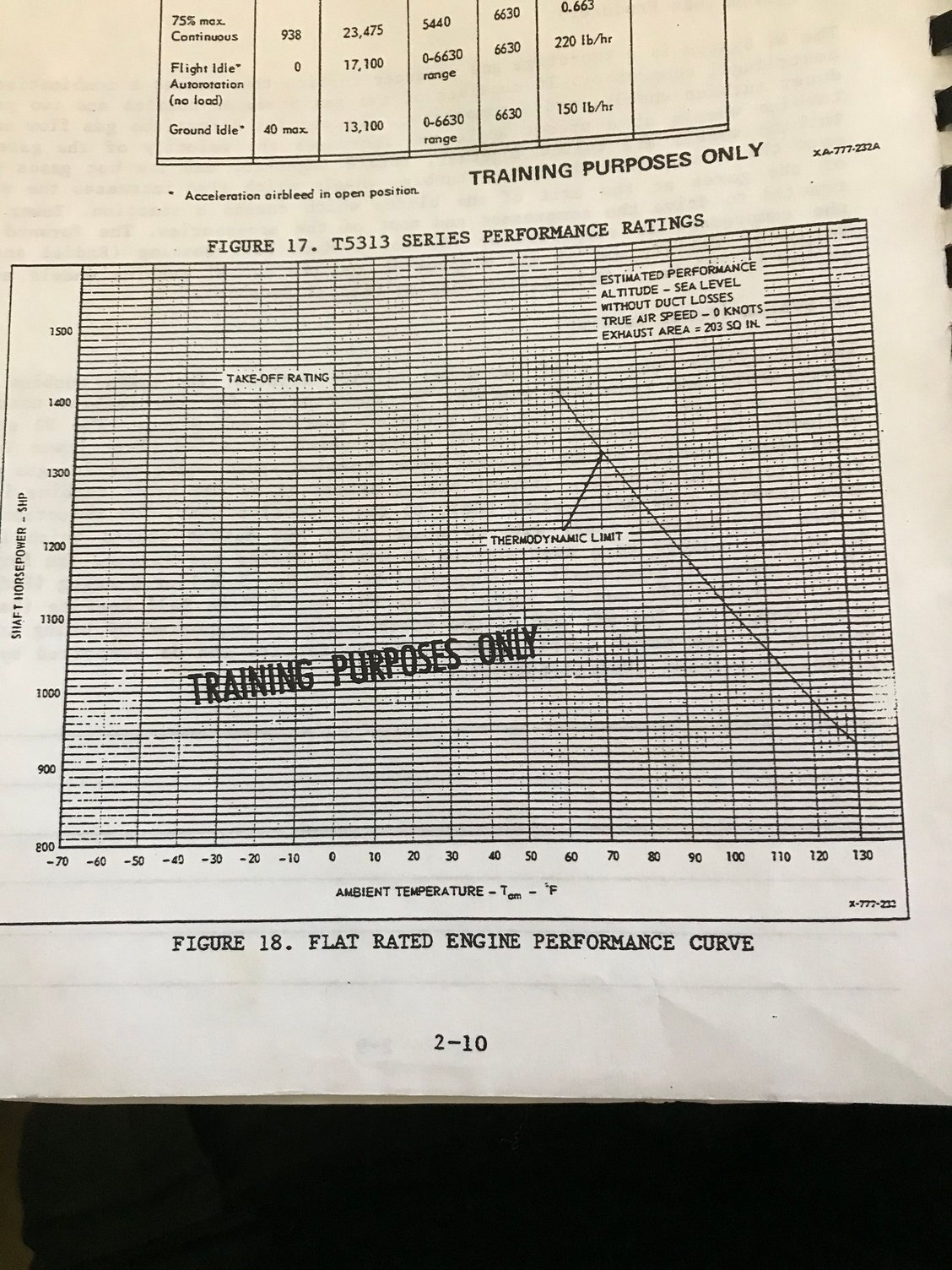

Fuel consumption based on performance rating Knot-Right correct me if I have this wrong.
T53-703
Idel 22GPH each engine
75% = 1125hp 102GPH each engine
100% = 1800hp 144GPH each engine
3 x 400R = 1200hp will burn 105GPH
1 x Mecury 1305hp I think they consume around 120 GPH if not more.
But we are burning kerosene or off-road diesel at a lower cost than 91 octane gas.
Not that you buy a turbine boat and worry about fuel consumption but I thought this would be a good comparison.
Add about 10-15 percent to those numbers for a real comparison.
The turbines are rated at a standard day ambient temperature of 59 degrees f . Anything above this ambient temperture one must not exceed the thermodynamics limits
of the engine.

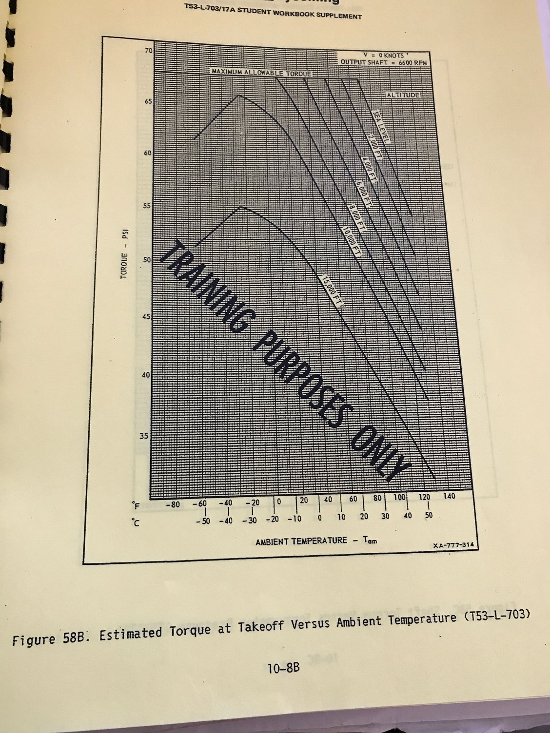

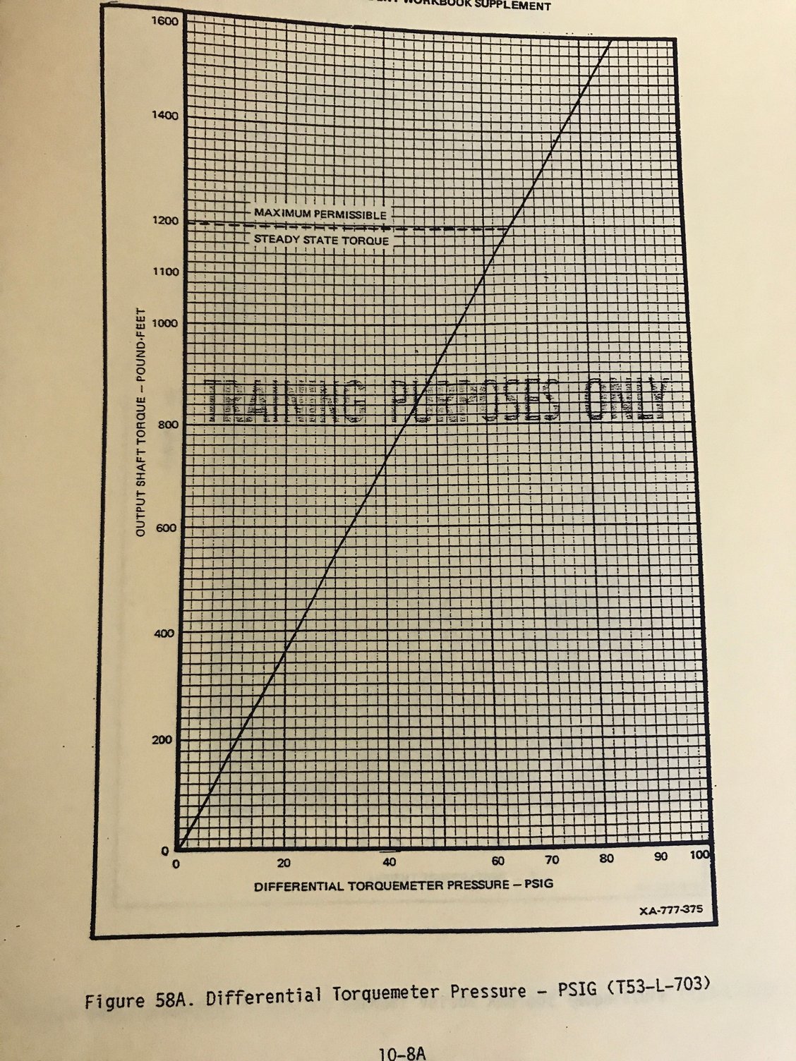

the t53 has a built in torque measuring system so the pilot may accurately measure mechanical limits while in opertation
it is a basic dash mounted pressure gauge.
When i push my throttles forward my gauge easily exceeds 85 psi.
i have heard some guys have seen over 100
KNOT-RIGHT is offline
