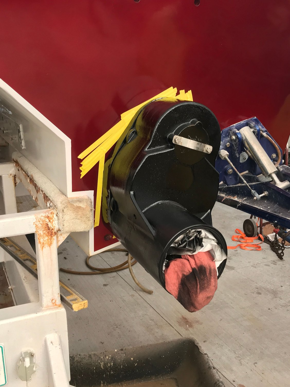

ICE Ratio is stamped on the inner casing or you could put a mark on the output flange turn the prop shaft one revolution and see where the output shaft finishes

Ok managed to get you some dimensions today.
The transom is around 4 degrees and running a straight edge through the centre of the drive the trust socket bottom is around 1" higher than the running surface

thank you so much for the info and pictures!!
One more question if I may in the running surface picture you showed me with the level,
if drive was trimmed all the way down how much would the casing right behind the prop be under the running surface?
The Skater runs a 16 degree transom so its designed for a Sterndrives.
I had to configure the bpms with wedges to run close to that 4 degrees. John Coskner confirmed mystics 50 is 4 degrees also.
