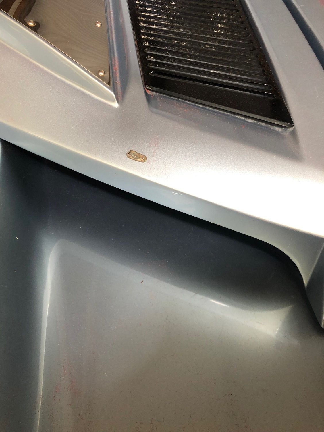

I noticed these act as large ducts drawing air out of the engine bay also didn't realize at first as the hatch overhang conceals them and helps keep water out.
